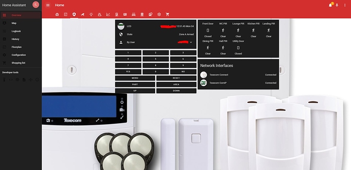

90% there, Had to do this via Node-Red though.

In my configurarion Node-red communicates via the COM IP. And the connect app or wintex communicates via connect interface.
I’ve published my library. I need to add some more comments as well as an example…
