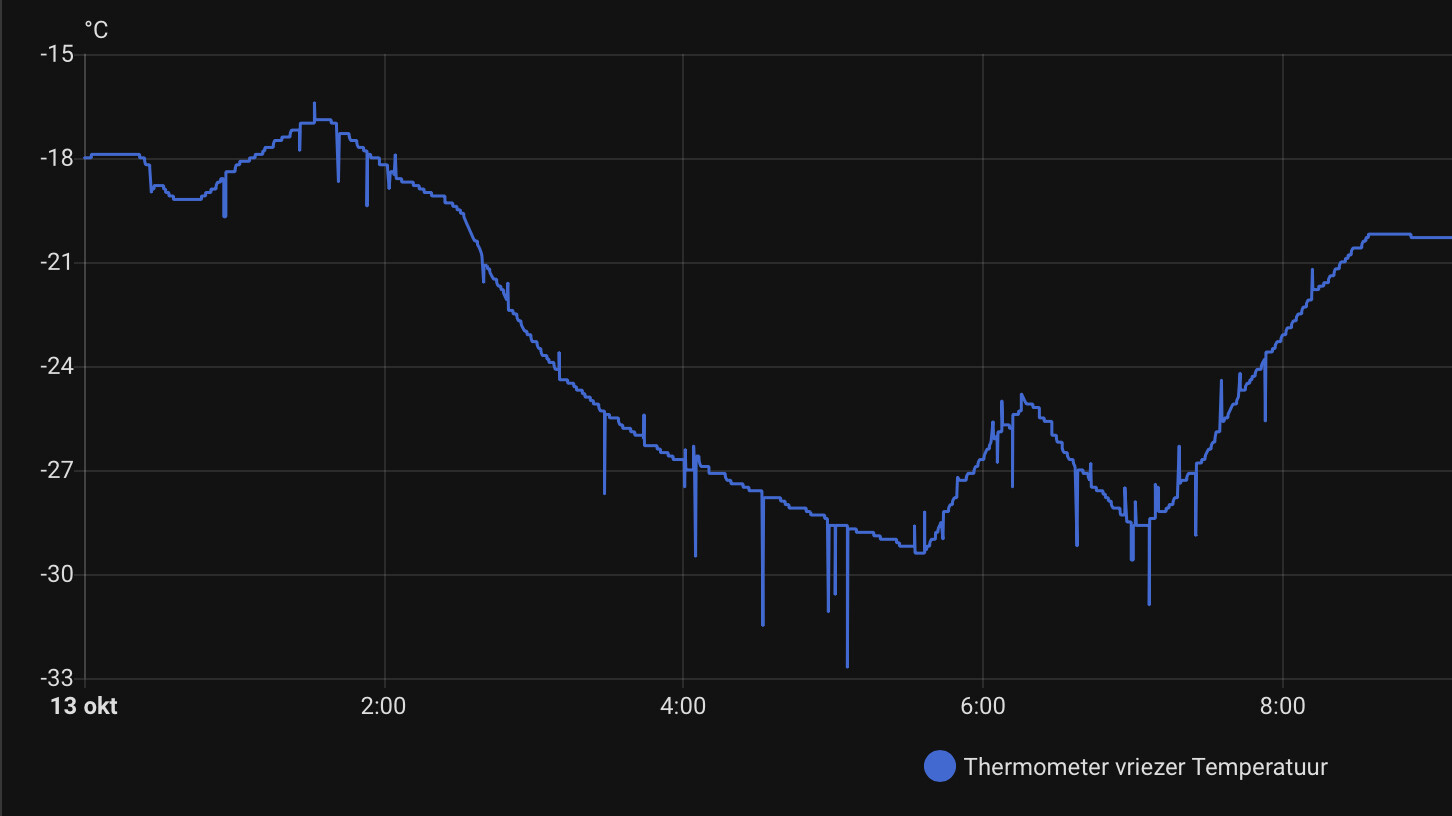

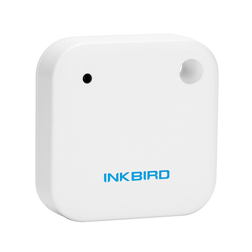

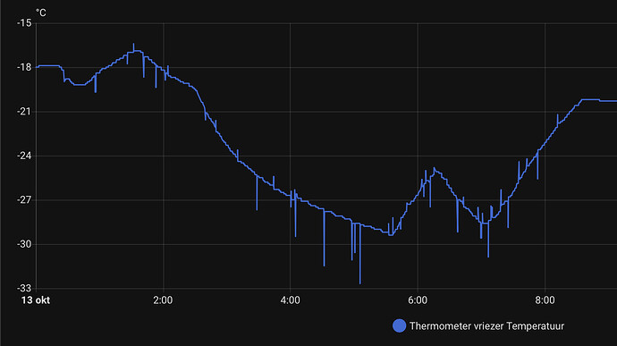

I would first try the Inkbird temperature sensor. If it does not pan out it can be put to other use. Yes, it is battery driven, AAA. But for that I would recommend lithium (not rechargeable Li-ion, but Lithium metal). They last long and do well in my freezer (albeit I have not tried setting that to -40 :slight_smile: The freezer does hit -30 at times in regular intervals. The cells can take up to -40 degrees Celcius and +60 in the sun.
https://lygte-info.dk/review/batteries2012/Energizer%20Ultimate%20Lithium%20AAA%20UK.html
This is what I have in my car (using exacly those cells):
Freezer with Inkbird thermometer (the version without hygrometer) and lithium cells, lasts longer than a year this way:

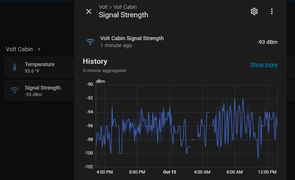

I also use a BT temp sensor in my car for help tracking car presence and cabin temp.
I use a govee h5075 and some basic aaa rechargeables. I keep it out of direct sunlight, and it has lasted many months before needing batteries swapped, and several years over all. I have a handful of these devices, for around the house and in fridges/freezers.
My cabin temps have generally ranged from ~110 to ~20 F.

edit: also the govee (or others I assume) can be directly used to determine if the car/device is home/in range via the bt signal strength (assuming you have reliable/close HA BT dongle)
