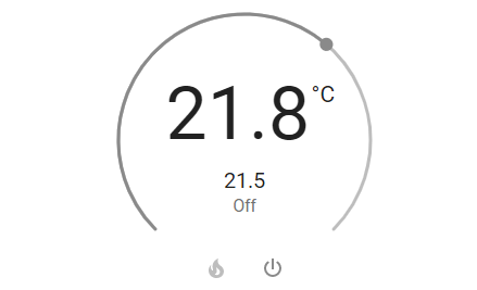

for few weeks everything worked correctly, but in last 3 days my thermostats started to switch on and off by it self randomly, also the target temperature keeps changing.
HW: tasmotized Sonoffs
even when I turn it off manually, it turns on again:
also in Log is just call by service - how can I identify what triggered it?
