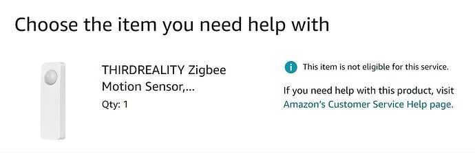

I was looking in my order history. I see that now on the product page but I get this when clicking support.
