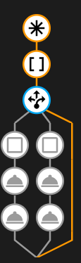

This is excactly what im lookibg for ! Thanks! Unfortunately I can’t get it to work . I am no expert, but I was able to find out , it looks like it passes right by the action part, even though it’s triggered? I will try to change the threshold and a few other things to see if I can get it working . I would be very glad if you could have a look at the screenshot, maybe it’s a very obvious mistake?

Sorry @Christer84 but what is that screenshot? Is a visual representation of the automation?
