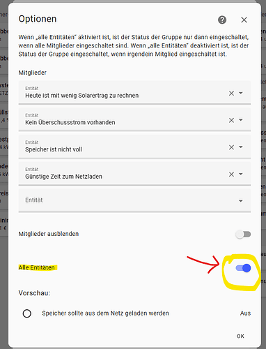

- a group-helper for binary_sensors that is ON when ALL of the above binary_sensors are on and OFF if at least one of the above binary_sensors is OFF. I set this up via UI like this:
It is important to toggle “all entities” on for the disrciped behavior

Is there a problem with the Tibber integration?
I have the same issue since update to 2024.11 today… but i read the prices directly via rest-api also, there is everything ok…
Hi, can someone tell me where or how I have to put this sensor on?
template:
- trigger:
- platform: time_pattern
hours: "/1"
- platform: homeassistant
event: start
action:
- service: tibber.get_prices
start: "{{ (now()).strftime('%Y-%m-%d %H:') + '00:00' }}"
end: "{{ (now() + timedelta(hours=states('input_number.tibber_cheap_energy_prices_hours') | int(default=24))).strftime('%Y-%m-%d %H:%M:%S') }}"
response_variable: action_response
binary_sensor:
- unique_id: tibber_next_good_grid_charging_time
# replace "Zuhause" with the name of your "home" in the tibber-integration
state: >
{% set min_price = action_response["prices"]["Zuhause"] |map(attribute='price') | list | min | float(default=0) %}
{% set max_price = action_response["prices"]["Zuhause"] |map(attribute='price') | list | max | float(default=0) %}
{% set lowest_price_entry = action_response["prices"]["Zuhause"] | min(attribute='price') %}
{% set start_time_lowest_price = lowest_price_entry["start_time"] %}
{% set end_time_lowest_price = as_datetime(start_time_lowest_price) + timedelta(hours=1) %}
{{as_datetime(now()) > as_datetime(start_time_lowest_price) and as_datetime(now()) < as_datetime(end_time_lowest_price) and (max_price - min_price) > states('input_number.tibber_cheap_energy_min_price_difference') | float(default=0) }}
attributes:
min_price: >
{{min_price}}
max_price: >
{{max_price}}
price_range: >
{{max_price - min_price}}
start_time: >
{{start_time_lowest_price}}
end_time: >
{{end_time_lowest_price}}
prices: >
{{action_response["prices"]["Zuhause"] | list}}
i think this from another source ![]()
I got the same issue with the max price, which is an issue for my loading from grid automation.
Any thoughts on how to fix this, more than welcome!
Same Problem here. Configure code in configuration.yaml,
but no values on: tibber_next_good_grid_charging_time
Think trigger don´t work, need to put code in automations.yaml ?
Reload the integration
