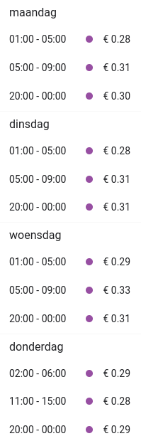

I have a related Tibber use case: I use Home Assistant to activate my thermostat/heat pump when energy rates are lowest.
Since it doesn’t make sense to cycle a heat pump on-and off every hour I made my solution a bit smarter: I search for three continuous blocks of 4 hours in length where the average price is lowest (so 12 hours per day in total when heating is available).
To achieve this I created an external Python script that runs once per day to obtain pricing data from Tibber, I then use the Home Assistant API to plan calendar events for the time windows that I want my heating to be available. Finally the calendar triggers an automation that activates or deactivates a generic thermostat that controls my heating.
The title of each event contains the average price for the four-hour span (including tax, rounded to two decimal places):
Hourly prices are added to the description of each span:
Using a calendar to show hourly pricing would be easy: simply plan events for every hour with the pricing info in the title.
