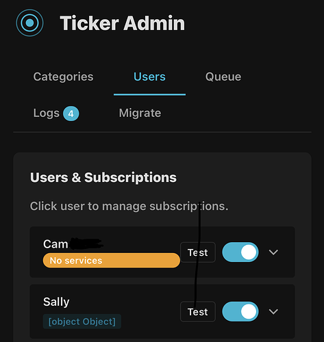

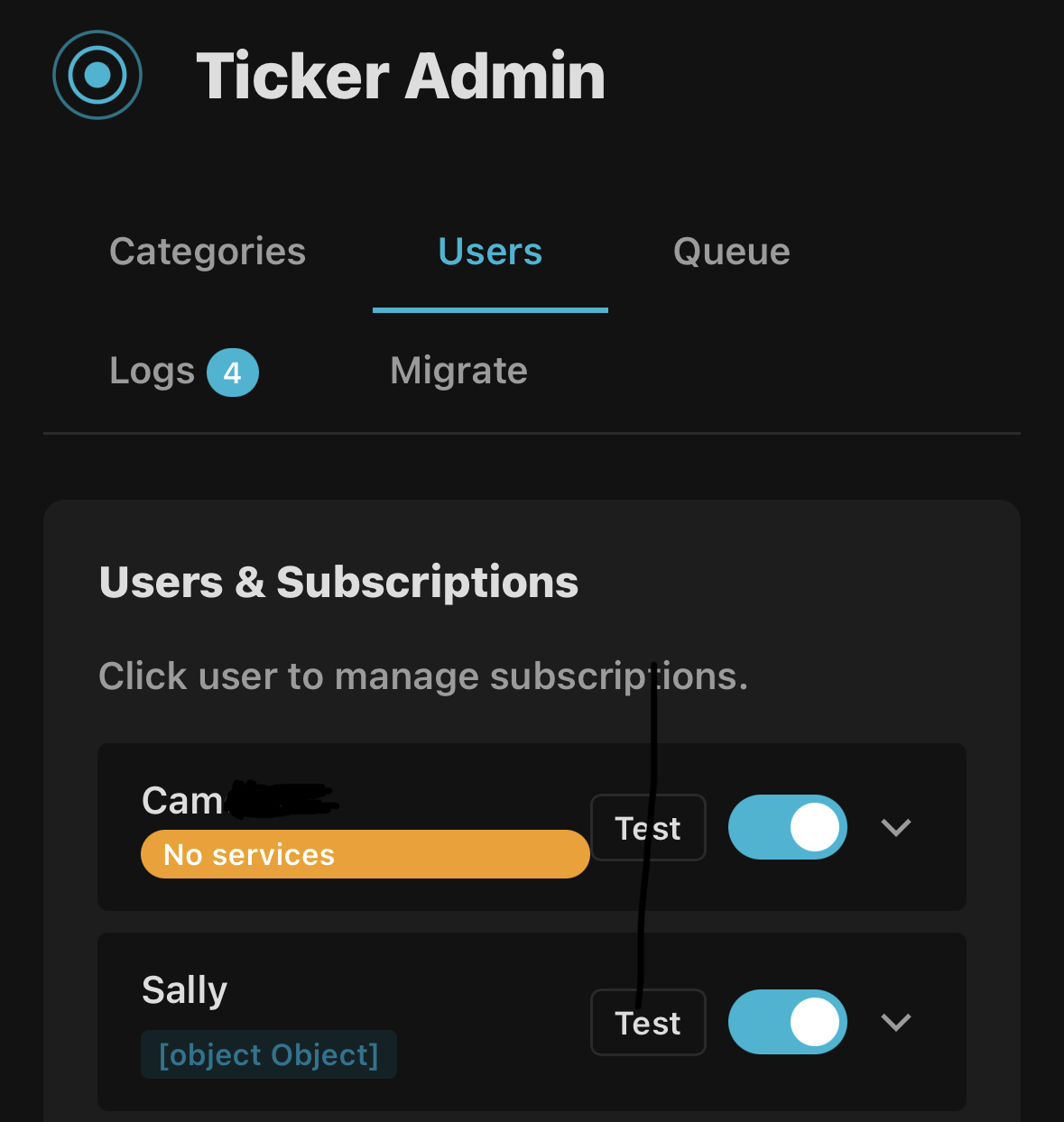

Hi Thank you for this integration.
I did a test and my wife received the message but I didn’t.
Any help

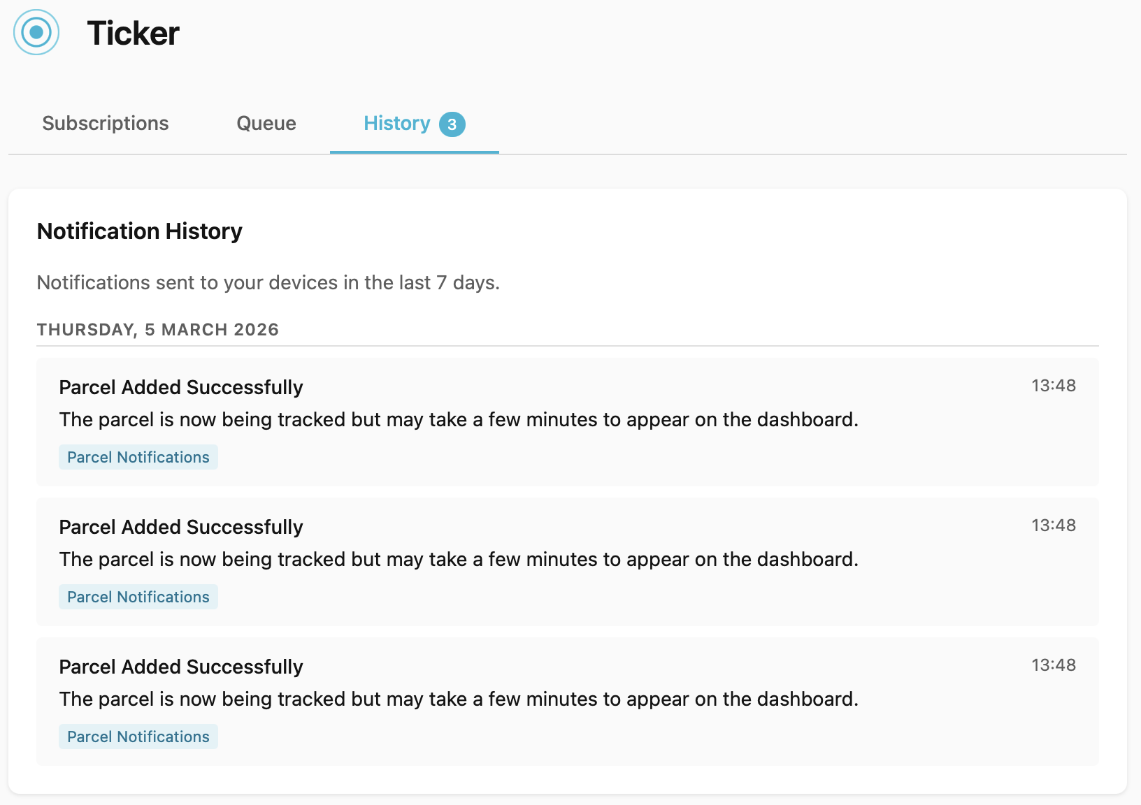

I’m testing out the integration. It’s early days yet but it looks really useful and I particularly like that individuals can decide which notifications they want to receive. Nicely done!
One comment I have though is on the history tab. I triggered one of my automations to send a test notification which get sent to my three devices (no surprises there). The history shows three notifications but doesn’t say which device they are sent to - so when reviewing the logs it’s not clear whether these are three separate notifications each sent to one device or one sent to three devices. I would expect if a separate entry is shown per notification & device combination that the log would also show the device. Alternatively the log should show a single notification in the history (with to without the devices it is sent to ). I hope this makes sense.

Hi Adrian,
excellent feedback, and as I myself have notifications limited to one device I overlooked that! Keep an eye on this thread, I will have a look over the weekend to group notifications as you suggested and add it to a next version
Hahaha… I could have easily missed this too. Ordinarily I would have most notifications sent to a single device only as well but I need to work out which device is my new iPhone rather than my old one first (and I was too lazy at the time of testing). :smiley:

I just released v1.1.0 which includes the grouping fix. Let me know what you think!

I’m still new to Home Assistant, with a freshly installed and fully updated Home Assistant Green, so I may simply be missing something obvious.
I’m currently testing Ticker, but in Ticker > Subscriptions, I get the following message:
No notify services No notification services linked.
However, on the Home Assistant side:
  • notify.mobile_app_[PHONE] does exist
  • sending a direct test notification works correctly
  • my user is properly configured in Settings > People
  • the phone is correctly linked to that person
  • the phone’s device_tracker exists and is used as the person’s source
I have also already restarted Home Assistant after checking everything.
So I’m wondering whether:
  • I missed an additional setup step,
  • there is a specific Ticker configuration detail I’m overlooking,
  • or this could possibly be a discovery bug.
Thanks in advance for your help, and apologies if this is a basic question.
Hi! Thanks for reporting this, and no need to apologize: this is a great question that actually helped me identify an issue.
You haven’t missed a setup step, this is a problem on the side of Ticker that only affects fresh installations and wasn’t picked up because of that. Definitely something I need to fix, which I will do later today.
What you can do right now to verify your setup is correct:
  1. Go to Developer Tools → Actions
  2. Search for notify.mobile_app
  3. Confirm your device shows up there (it sounds like it does, since direct test notifications work)
If it shows up there, your HA setup is 100% correct — Ticker just isn’t picking it up yet due to this discovery gap.
I’ll post an update here once the fix is available. Thank you for taking the time to report this, it’s exactly the kind of feedback that helps me improve this!
Thanks a lot for the clarification and for looking into it so quickly.
I confirm that notify.mobile_app_* is present in Developer Tools and direct notifications work correctly on my side.
I’ll wait for your update and test again once the fix is available.
I just tested version 1.2.1 and everything is now working correctly on my side.
Thank you very much for the quick fix and your help.

Just started testing this. I’m having nothing show up except my pixel watch. Verified the notify.mobile is there. I’m on version 1.2.1.
Anything I can provide?
EDIT: I discovered the problem. The device name and the “notify” name need to match.
