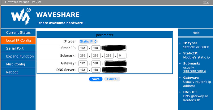

This is what a working waveshare converter looks like:

I configured the waveshare with the same parameters as yours, I installed the taptap from repository on HA which connects correctly, but I have no data from the panels. i not undestand if must configure other, this id the log

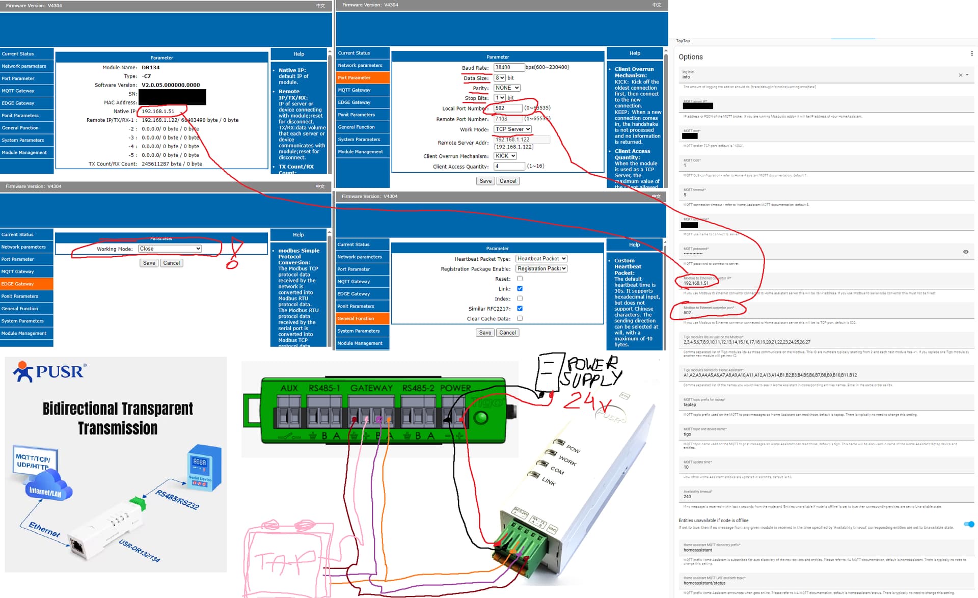

Cheap device no need for additional power supply ( 5 to 24V )
I my case i’ve used same power supply that supports CCA
Some pannels are responding longer than 120 seconds so 240s for avability timeout is fine.
See attached configuration from my screenshots. There are all settings for proper working device. In HA i have mosquitto broker working and i’ve used user and pass for mqtt from there. As allways first you need to set proper network configuration becouse device has staticIP 192.168.0.7 and you need to be in same network to change it. Device is small like lipstick , fast and easy to instal. I’am using it over a week with no problems. Cheers
