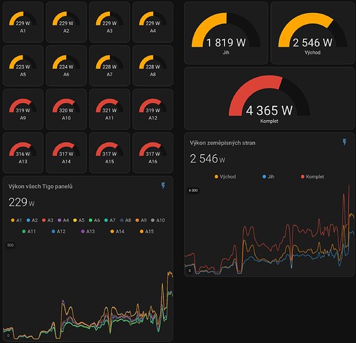

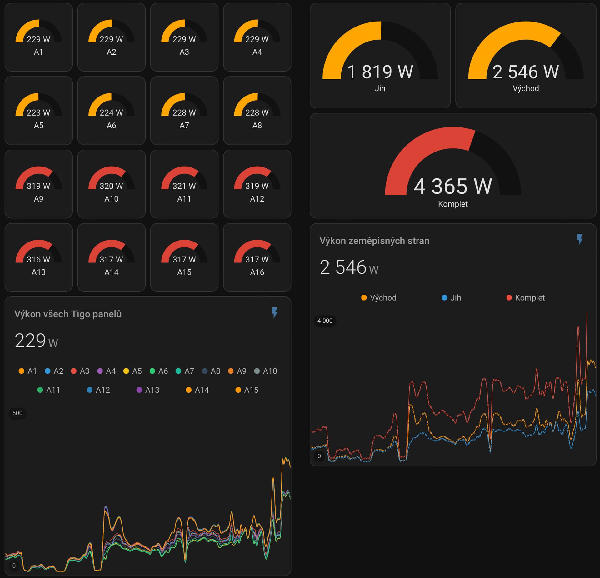

And this can be read directly into Home Assistant as sensors.

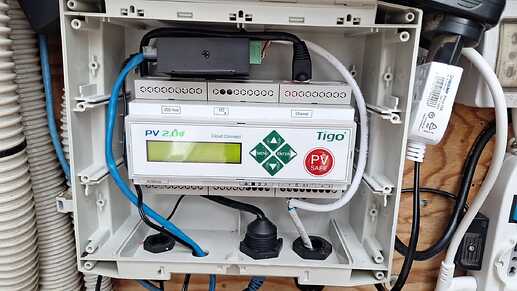

Hey folks. I just had a solar install in the UK with a Tigo CCA and optimisers for all my panels.
I’m really pi**ed off at the cloud requirement, and generally the state of data ownership in solar installations; my sunsynk inverter also came with some stupid cloud only logger, which I’ve since replaced with a USR-W630 for local access.
Since the installers haven’t given me access to the app for days since installation of the Tigo, I decided to play around a bit.
It’s on 4.0.1-ct, I have access to all of the web UI; the summary page is available with the standard credentials, however, for the “main” UI with all the settings etc, I have to use the 10.11.1.1 trick. I have no idea what I can do with the stuff in that web-UI, it has a lot of features, but I noticed “LocalDataAccess” tab which requires a password, and I don’t see anywhere online what that password could be so I can’t look any deeper.
I’m curious; if I got another USR-W630 for RS485->WiFi, can I use that and remove the CCA entirely, or is the CCA still required to be in the system for things to function?
If I block the CCA from the internet because I’m using other local-access addons, will that cause any issues? I saw elsewhere mentions of the data storage filling up because of data not being able to send to the server. Those addons provide much less detail though, unfortunately.
If I can’t get much further with the access I have, I will disassemble the CCA and use hardware means to gain root access for more tinkering but was hoping to avoid that.

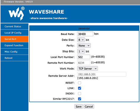

Hello there,
my tigo firware are locked, so I tried to buy a waveshare and install the hassio addon.
I think I change everything as per instruction (like the pics pubblished), but everything is marked offline.

@josher-mi I bought the same exact convert with the same settings of your pics, but it doesn’t communicate with tigo.
maybe I have to change something in expand function and/or misc config?

  1. You need to have Linux on some computer.
  2. You need to properly setup Modbus converter
  3. Go to my fork of taptap binary repo download latest compiled binary a try to get it running from the command line in the: peek-bytes and peek-frames modes first. You will see if you receiving any packets and if taptap understand those.
