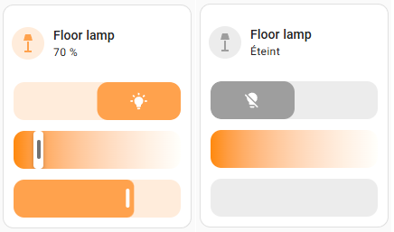

I would suggest as a generic UX principle for features to try as much as possible to have the features reflecting the state of the entity (like the icon) thus most of the time:
  • grey when the entity is OFF (light grey or dark grey depending the theme)
  • with the relevant color when the entity is ON
    Best example of inconsistency with the light (color temp slider kept orange when light off):

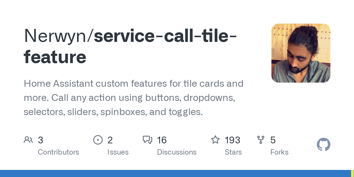

The feature customization part has been made partly available in HACS through this project:
But not embedded into a core card, and despite the available Graphic Interface, the usage can be sometime difficult.
Feature consistency
obvious (not perfect) example with the light entity:

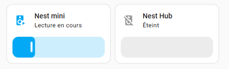

Good example with media player volume slider:

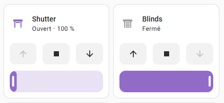

Questionable case for covers position slider:

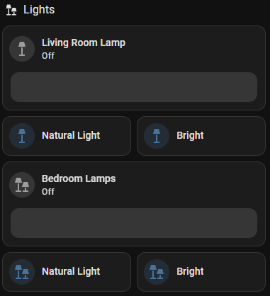

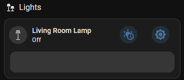

The new Tile cards are great but I want a cross between the entities card and the tile card.
What I have now:
What I really want:
Bubble cards might be able to help with that, but I agree adding these features to Tile Cards would be great
