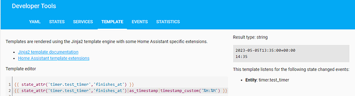

I’ve just created a test timer, started at 12:35 BST for two hours.
Those templates are:
{{ state_attr('timer.test_timer','finishes_at') }}
{{ state_attr('timer.test_timer','finishes_at')|as_timestamp|timestamp_custom('%H:%M') }}
Does that give you what you want?
