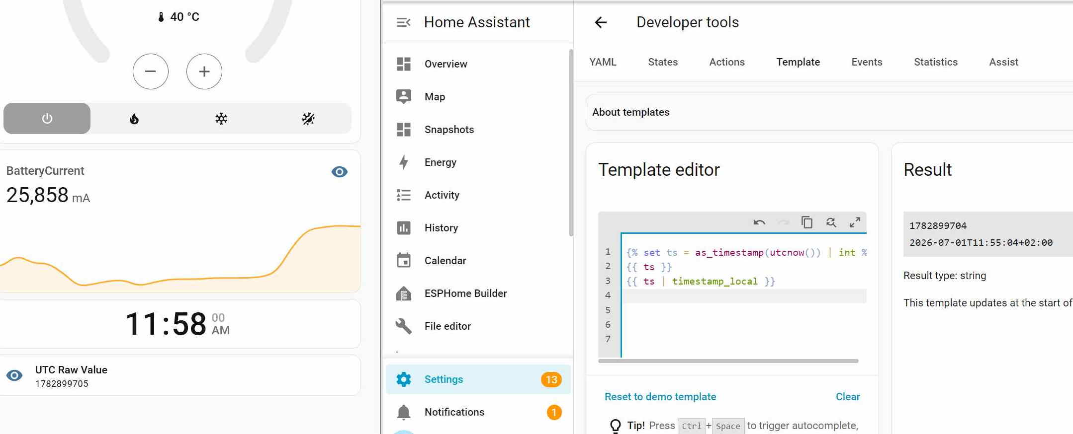

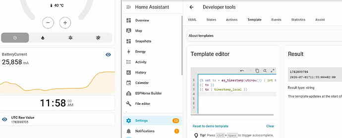

Those 170 seconds are the offset of the REAL time (which is correctly displayed and used in HA) and the WRONG raw value. I hope the attached screenshot describes ?!

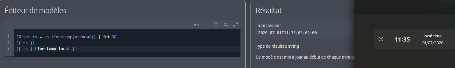

Why you HA clock is off by 170 sec? I don't know, but mine is surely not:

Tried in the template editor just as you did and still the offset. Well if it is only at my installation ... miraculeux !
Show us the same screenshot as I did :wink:

At the left side of the screenshot is a simple clock card (GMT+01:00) Vienna
it shows 11:58 and the same rawvalue (+/-1) right ?
