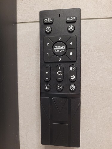

I’m also interested in this as I have the same device as you! Are you certain that remote is bluetooth based and not RF?
I have taken apart the remote control and this is the component inside. Anyone knows what kind of tech is this? BT, RF or something else?
I don’t know, was expecting BT as there is a Bluetooth device available and the remote control looks like being a BT remote control.
