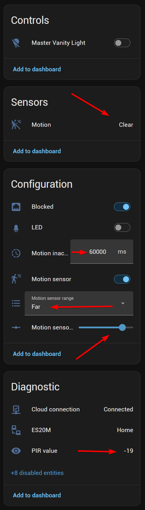

I made HACS that exposes the PIR sensor: GitHub - CrazyCoder/hass-tplink-pir-patch: Home Assistant custom integration exposing python-kasa PIR / motion-sensor features (ES20M, KS200M) that the built-in tplink integration doesn't wire up. HACS-compatible. · GitHub.

UPDATE: I have the HACS working, pretty easy actually.
  1. I updated the configuration.yaml with just the text, tplink_pir_patch:
  2. I was able to create an automation via the automation UI to trigger off my ES20M.
  3. In my initial effort I had also entered the sample automation into the automation.yaml so I had two automations, one entered via the UI, the other taken from GitHub documentation and modified. The GitHub version worked so I kept it and deleted my other automation created via the UI.
