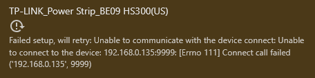

I have 27 various TP-LINK smart plugs and switches happily connecting to my Home Assistant for a very long time. I just now upgraded from 11.1 to 11.2 and now my HS300 power strip is not connecting.
The power strip responds locally 200 OK on port 80 and works correctly when using the official Kasa app. All other TP-LINK smart plugs/switches are working just fine in HA.
I’ve done a hard power reset on the HS300 (unplugged it from the wall, waited 10 seconds, and plugged it back in). It still responds 200 OK on port 80 locally and works fine with the Kasa app. I’ve rebooted HA twice.

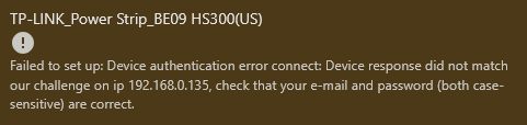

Now without doing anything, the error message has changed to “enter username and password”, but only on this device (all others are fine, including the other HS300 I have).
No other TP-Link device on my network has asked for a password. Is there a default local device admin password I should use?

The troublesome HS300 device is hardware V2, firmware 1.1.2, and returns 200 OK when opening port 80 using a web browser, but times out on port 9999. The other HS300 that works fine is hardware V1, firmware 1.0.21, but it times out on ports 80 and 9999.

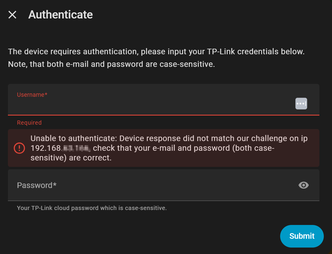

I am experiencing the same authentication failure (requesting Kasa Cloud credentials which continually fail) for only a single HS300 power strip that has worked for at least a year, but suddenly stopped being “registered” in HA after a brief power outage this morning (I managed to do a shutdown of my main computer, but HA remained on and simply cut out when the battery backup ran out of power)…so the HA shutdown (running on an older Dell mini PC (formerly a Chromebox) was not “clean”. But reading through the rest of the posts here, I don’t think that was the issue. I’m betting that something in the API changed and now needs to be tweaked by the devs to correct the situation, because the HS300 is the only one of 37 other Kasa/TP Link devices that has run into the issue. All others are working just the same as before.
I have verified the IP address of the HS300, and it is working in both the TP-Link Tapo App and in the Kasa App on my Galaxy. The only issue now is that it will not “authenticate” in HA. Here’s what I’ve done:
  1. Tried to input my credentials for Kasa Cloud (as requested)-- verified they are correct by logging into the Kasa web instance. Even changed my password and retried that to verify that it was correct; also turned off and on 2-factor authentication just to see if that matter-- it did not…Still no joy.
  2. I removed the HS300 from HA and allowed the HA TP Link Integration to “Discover” it again (it did), but trying to then add it by clicking on the green “Add” button, simply results in yet another “Authenticate” dialog where entering the username and password result in "Unable to authenticate: Device response did not match our challenge on ip 192.168.1.XXX, check that your e-mail and password (both case-sensitive) are correct. " So log-in loop hell…
  3. After reading everyone else’s comments, I’m just going to wait to see if the devs fix this in the integration for TP Link…
