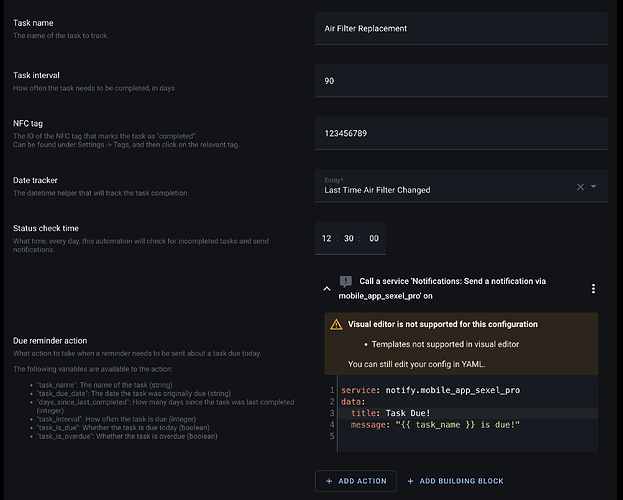

  3. Create a new automation using the blueprint (Settings → Automations & Scenes → “Create Automation” → Select “Track and Remind about a Task” from the list)
    1. Task name: The name of the task. This will be available in the due/overdue/completed actions as {{ task_name }}
    2. Task interval: How often the task needs to be completed, in days (min: 1, max: 365)
    3. NFC tag: The ID of the NFC tag (created earlier) that, when scanned, will mark the task “completed”
    4. Date tracker: The Datetime helper (created earlier) that will store a timestamp of the last time the task was marked “completed”
    5. Status check time: The time, every day, when this automation will run to check for due/overdue tasks and potentially trigger reminder actions.
    6. Due reminder action: An action (or series of actions) to take when a task is due today.
    7. Overdue reminder action: An action (or series of actions) to take when a task is overdue. If not set, will automatically use the same action(s) as Due reminder action.
    8. Days of the week to skip: Optional days of the week to skip running the status check. For example, skip checking for due/overdue tasks on weekends.
    9. Use rolling completion: When marking a task as “completed”, whether to mark it at its original due date or today. Useful if you don’t want the delay in completing the task to affect the next time the task is due.
    10. Action upon completion: Optional action(s) to take when a task is marked as “completed”.

This is really cool, thanks for putting it together.
I’m experiencing difficulty with the {{ }} variables. I’ve filled in the Task Name field and then set the message as is written in a screenshot "{{ task_name }} is due" but when I run that action to test it, the message received by my phone is is due.
Basically the variable isn’t getting parsed/passed to the message. Am I doing something wrong?
Hmm, could you share a screenshot or the YAML of your automation config? And/or the trace of when it ran, specifically the “Changed Variables”? You should see a “task_name” variables, like this:

Hmm, that’s weird. I’m not able to recreate that on my end. As you can see, it populated task_name (“Test ting”) correctly for me:
This blueprint doesn’t really have a visual component to it. The task name only exists in the automation; it’s not an entity that can be visually displayed or is recorded anywhere.
This blueprint only relies on a “last completed” timestamp, so that’s the only entity you’d have to put on a dashboard, as you’ve discovered.
