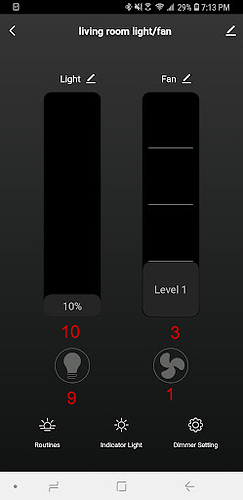

I’m interested in the entities config as well. I don’t get it & the LocalTuya docuementation doesn’t relate what each value is? I get the Tuya IOT portal & those settings, but I don’t necessarily understand the correlation between that & the LocalTuya entity config. I tried following your example of the ID: 1 = fan, ID: 9 = light, but what’s the correct entity to pick from the beginning? I selected switch kinda mapping it to IOT debugging.

After some repeated configure/deleting the localTuya integration with this Treatlife, I was able to determine what each of the main IDs are . . . except I just get an on/off switch for the brightness or speed? I can’t configure 2 switches, the second I try to do so, it just says “successfully added”.
I’m also not sure what the 3 digit IDs are.
As for the entity types, if I set select “fan”, I set the ID = 1, Fan Speed Control = 3, I still only get a single entity as an on/off switch. How do I control the speed? If I set both to ID/FSC to 3, I still get a switch.
Same thing for trying to set light entities. I’ve tried ID = 1, Brightness = 10 & ID = 10 & Brightness = 10. I get 1 entity if I do light/fan & I don’t see any changes reflected in the Tuya Smart app or Tuya IOT debug portal.
See? I just get a single entity with on/off capabilities? Are ya’ll getting the ability to select the speed/brightness? (I tried to see what ID 105 does as a switch, but it starts on & just turns back on after turning off)

Ok, I think I know your issue. You got everything right, only annoying part is that there are 4 speeds (still haven’t figured what to do for that) but the issue is that you need to add a few special cards to add it to an entity. I suggest the slider-entity-row, use HACS and search in the front end for it.
all you need to do is follow the info and use the code editor.
So add it as {Light: {ID: 9,Brightness: 10}}? and for the {Fan: {ID: 1, Speed: 3}}?

Find the device by ID (if on your network). Enter information required and profit. Switch 9 is the light portion. Switch 1 is the fan, if I remember correctly.

Finally got back to this. Originally I used the Treatlife app with this switch, so I couldn’t add it to HA via the Tuya Integration. I factory reset the switch and then added it to the Tuya Smart app. (FYI to factory reset, hold the light switch for 5 seconds. The WiFi light within the light switch will begin flashing quickly. Hold the light switch again for 5 seconds. The WiFi light within the light switch will begin flashing slowly, indicating pairing mode is ready).
Went through all the instructions to setup the Tuya Integration, which were great. In the end, my fan/light switch device was successfully added to HA. However, just like so many have mentioned here, I only have two entities, as shown here:
When I activate the fan toggle, it sets it to Level 1 in the Tuya Smart app, and the fans speed at that level (very, very slowly). Any ideas on how to get all 4 levels?
