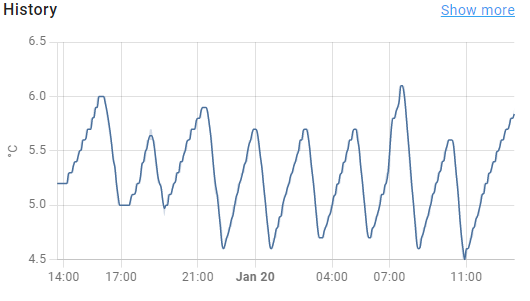

Fridges and freezers fluctuate a bit in temperature, so the risk/chance that the value is exact the same if I check twice or a few times in a row is not so likely:
Idealy I would like to see if the last three-four values is identically and then trigger a notification…
