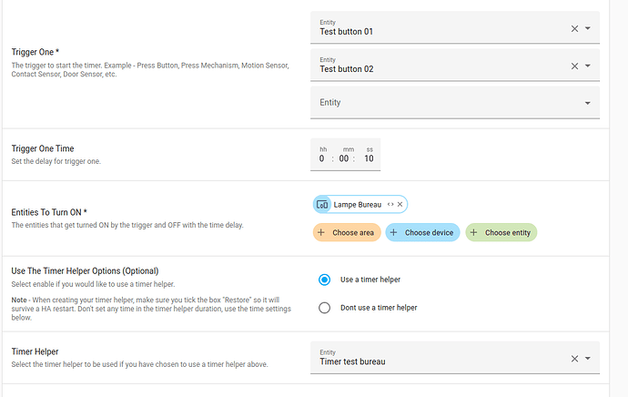

Hi again,
I’m still testing your blueprint. I’m facing an issue when I use a timer helper:
Everything goes well until the timer is over:
When I click on the trigger-button, the timer looks good:
At the end of the timer, the light doesn’t switch off and in the log:
homeassistant | 2024-02-23 08:45:04.024 WARNING (MainThread) [homeassistant.components.automation] Error evaluating condition in 'Test timer bureau':
homeassistant | In 'condition':
homeassistant | In 'or' (item 9 of 10):
homeassistant | In 'and' (item 3 of 3):
homeassistant | In 'template' condition: UndefinedError: 'dict object' has no attribute 'entity_id'
I don’t understand my issue… ![]()
Thank you in advance !
It is probably because you are using a device and not an entity. But have a look at this blueprint
Manual light control with auto OFF it may be more inline with what you are trying to do.
Blacky ![]()
Many thanks !!! I changed to an entity and now it works perfectly !! ![]()
