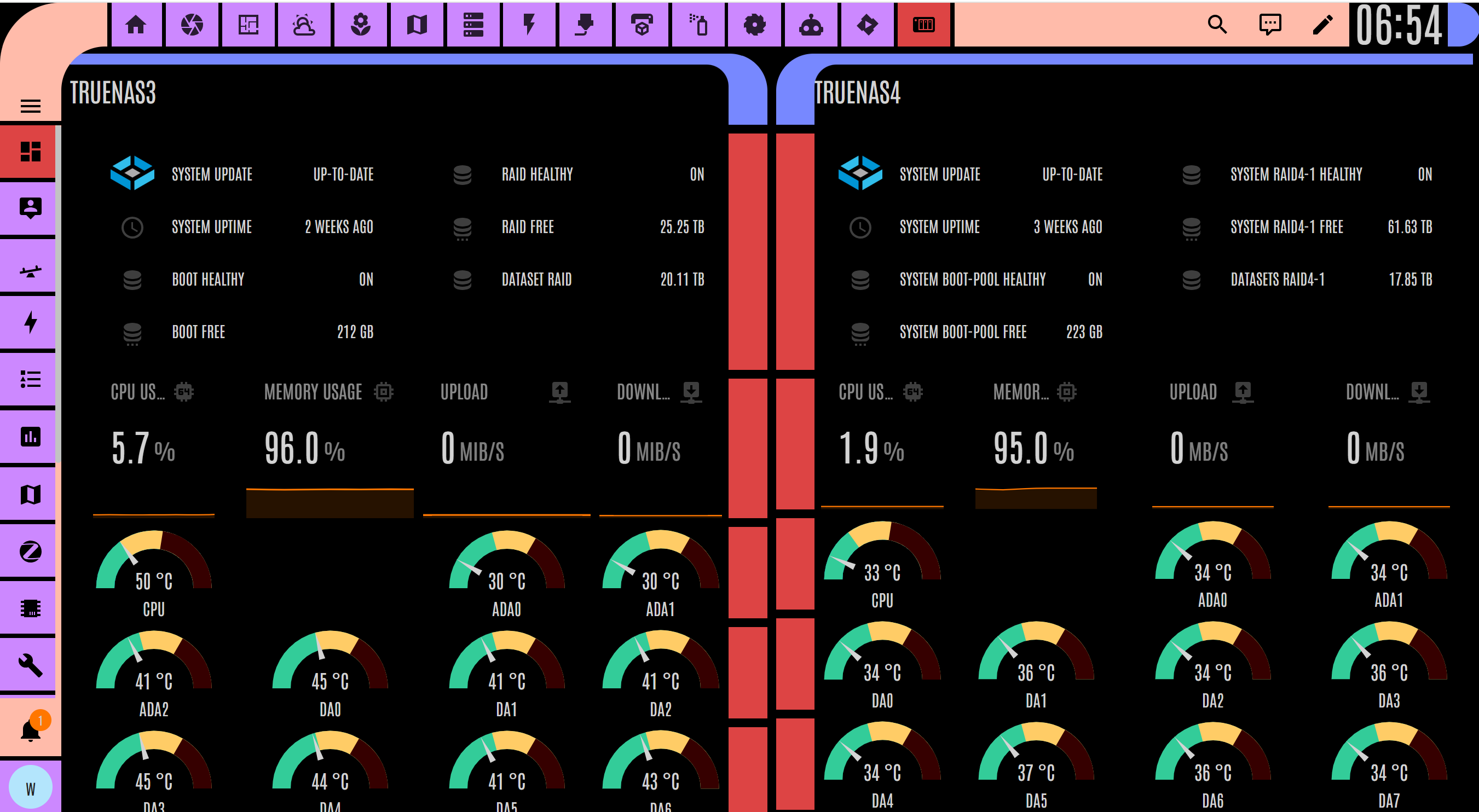

Anyone create a Dashboard for Truenas and or integrate the Disk Smart info ?
That is awesome, can you drop your YAML ?
This is the entire view/page card (have 4 instances of TrueNAS)… Also, there are some extra fields as I use LCARS for my theme.
icon: mdi:nas
path: nas
title: NAS
type: custom:grid-layout
layout_type: grid
layout:
  grid-template-columns: 50% 50%
badges: []
cards:
  - type: vertical-stack
    cards:
      - type: custom:html-card
        title: TrueNAS1
        content: " "
        card_mod:
          class: header-right
      - square: false
        type: grid
        cards:
          - type: entities
            title: ""
            card_mod:
              class: middle-blank
              style: |
                ha-card {
                  padding: 0px 21px 0px 21px !important;
            entities:
              - entity: update.truenas1_system_update
              - entity: sensor.truenas1_system_uptime
              - entity: binary_sensor.truenas1_system_freenas_boot_healthy
              - entity: sensor.truenas1_system_freenas_boot_free
          - type: entities
            title: ""
            card_mod:
              class: middle-right
            entities:
              - entity: binary_sensor.truenas1_system_raid_healthy
              - entity: sensor.truenas1_system_raid_free
              - entity: sensor.truenas1_datasets_raid
        columns: 2
      - square: true
        type: horizontal-stack
        cards:
          - type: custom:mini-graph-card
            entities:
              - entity: sensor.truenas1_system_cpu_usage
            decimals: 1
            upper_bound: 100
            lower_bound: 0
            card_mod:
              class: middle-blank
              style: |
                ha-card {
            decimals: 1
            upper_bound: 100
            lower_bound: 0
            entities:
              - entity: sensor.truenas1_system_memory_usage
            card_mod:
              class: middle-blank
            card_mod:
              class: middle-blank
            lower_bound: 0
            icon: mdi:upload-network
            entities:
              - entity: sensor.truenas1_system_eno1_tx
            card_mod:
              class: middle-right
            lower_bound: 0
            icon: mdi:download-network
            entities:
              - entity: sensor.truenas1_system_eno1_rx
      - square: false
        type: grid
        cards:
          - type: gauge
            card_mod:
              class: middle-blank
              style: |
                ha-card {
            entity: sensor.truenas1_system_temperature
            needle: true
            min: 20
            max: 120
            severity:
              green: 0
              yellow: 50
              red: 75
          - type: custom:gap-card
            card_mod:
              class: middle-blank
              style: |
                ha-card {
          - type: gauge
            card_mod:
              class: middle-blank
              style: |
                ha-card {
            entity: sensor.truenas1_disks_sda
            needle: true
            min: 20
            max: 80
            severity:
              green: 20
              yellow: 45
              red: 60
          - type: gauge
            card_mod:
              class: middle-right
            entity: sensor.truenas1_disks_sdb
            needle: true
            min: 20
            max: 80
            severity:
              green: 20
              yellow: 45
              red: 60
          - type: gauge
            card_mod:
              class: middle-blank
              style: |
                ha-card {
            entity: sensor.truenas1_disks_sdc
            needle: true
            min: 20
            max: 80
            severity:
              green: 20
              yellow: 45
              red: 60
            card_mod:
              class: middle-blank
              style: |
                ha-card {
            card_mod:
              class: middle-blank
              style: |
                ha-card {
          - type: gauge
            card_mod:
              class: middle-right
            entity: sensor.truenas1_disks_sdd
            needle: true
            min: 20
            max: 80
            severity:
              green: 20
              yellow: 45
              red: 60
        columns: 4
        title: " "
        content: " "
        card_mod:
          class: footer-right
    cards:
        title: TrueNAS2
        content: " "
        card_mod:
          class: header-left
      - square: false
        type: grid
        cards:
          - type: entities
            title: ""
            card_mod:
              class: middle-left
            entities:
              - entity: update.truenas2_system_update
              - entity: sensor.truenas2_system_uptime
              - entity: binary_sensor.truenas2_system_freenas_boot_healthy
              - entity: sensor.truenas2_system_freenas_boot_free
          - type: entities
            title: ""
            card_mod:
              class: middle-blank
            entities:
              - entity: binary_sensor.truenas2_system_raid_healthy
              - entity: sensor.truenas2_system_raid_free
              - entity: sensor.truenas2_datasets_raid
        columns: 2
      - square: true
        cards:
            entities:
              - entity: sensor.truenas2_system_cpu_usage
            decimals: 1
            upper_bound: 100
            lower_bound: 0
            card_mod:
              class: middle-left
            decimals: 1
            upper_bound: 100
            lower_bound: 0
            entities:
              - entity: sensor.truenas2_system_memory_usage
            card_mod:
              class: middle-blank
            card_mod:
              class: middle-blank
            lower_bound: 0
            entities:
              - entity: sensor.truenas2_system_lagg0_tx
            card_mod:
              class: middle-blank
              style: |
                ha-card {
            lower_bound: 0
            entities:
              - entity: sensor.truenas2_system_lagg0_rx
      - square: false
        type: grid
        cards:
          - type: gauge
            card_mod:
              class: middle-left
            entity: sensor.truenas2_system_temperature
            needle: true
            min: 20
            max: 120
            severity:
              green: 0
              yellow: 50
              red: 75
            card_mod:
              class: middle-blank
              style: |
                ha-card {
          - type: gauge
            card_mod:
              class: middle-blank
              style: |
                ha-card {
            entity: sensor.truenas2_disks_ada0
            needle: true
            min: 20
            max: 80
            severity:
              green: 20
              yellow: 45
              red: 60
          - type: gauge
            card_mod:
              class: middle-blank
              style: |
                ha-card {
            entity: sensor.truenas2_disks_ada1
            needle: true
            min: 20
            max: 80
            severity:
              green: 20
              yellow: 45
              red: 60
          - type: gauge
            card_mod:
              class: middle-left
            entity: sensor.truenas2_disks_ada2
            needle: true
            min: 20
            max: 80
            severity:
              green: 20
              yellow: 45
              red: 60
          - type: gauge
            card_mod:
              class: middle-blank
              style: |
                ha-card {
            entity: sensor.truenas2_disks_ada3
            needle: true
            min: 20
            max: 80
            severity:
              green: 20
              yellow: 45
              red: 60
          - type: gauge
            card_mod:
              class: middle-blank
              style: |
                ha-card {
            entity: sensor.truenas2_disks_ada4
            needle: true
            min: 20
            max: 80
            severity:
              green: 20
              yellow: 45
              red: 60
          - type: gauge
            card_mod:
              class: middle-blank
              style: |
                ha-card {
            entity: sensor.truenas2_disks_ada5
            needle: true
            min: 20
            max: 80
            severity:
              green: 20
              yellow: 45
              red: 60
          - type: gauge
            card_mod:
              class: middle-left
            entity: sensor.truenas2_disks_da0
            needle: true
            min: 20
            max: 80
            severity:
              green: 20
              yellow: 45
              red: 60
          - type: gauge
            entity: sensor.truenas2_disks_da1
            needle: true
            min: 20
            max: 80
            severity:
              green: 20
              yellow: 45
              red: 60
            card_mod:
              class: middle-blank
              style: |
                ha-card {
          - type: gauge
            card_mod:
              class: middle-blank
              style: |
                ha-card {
            entity: sensor.truenas2_disks_da2
            needle: true
            min: 20
            max: 80
            severity:
              green: 20
              yellow: 45
              red: 60
          - type: gauge
            entity: sensor.truenas3_disks_da3
            needle: true
            min: 20
            max: 80
            severity:
              green: 20
              yellow: 45
              red: 60
            card_mod:
              class: middle-blank
              style: |
                ha-card {
        columns: 4
        title: " "
        content: " "
        card_mod:
          class: footer-left
    cards:
        title: TrueNAS3
        content: " "
        card_mod:
          class: header-right
      - square: false
        type: grid
        cards:
          - type: entities
            title: ""
            card_mod:
              class: middle-blank
              style: |
                ha-card {
            entities:
              - entity: update.truenas3_system_update
              - entity: sensor.truenas3_system_uptime
              - entity: binary_sensor.truenas3_system_boot_pool_healthy
              - entity: sensor.truenas3_system_boot_pool_free
          - type: entities
            title: ""
            card_mod:
              class: middle-right
            entities:
              - entity: binary_sensor.truenas3_system_raid3_1_healthy
              - entity: sensor.truenas3_system_raid3_1_free
              - entity: sensor.truenas3_datasets_raid3_1
        columns: 2
      - square: true
        cards:
            entities:
              - entity: sensor.truenas3_system_cpu_usage
            decimals: 1
            upper_bound: 100
            lower_bound: 0
            card_mod:
              class: middle-blank
              style: |
                ha-card {
            decimals: 1
            upper_bound: 100
            lower_bound: 0
            entities:
              - entity: sensor.truenas3_system_memory_usage
            card_mod:
              class: middle-blank
            card_mod:
              class: middle-blank
            lower_bound: 0
            entities:
              - entity: sensor.truenas3_system_lagg0_tx
            card_mod:
              class: middle-right
            lower_bound: 0
            entities:
              - entity: sensor.truenas3_system_lagg0_rx
      - square: false
        type: grid
        cards:
          - type: gauge
            card_mod:
              class: middle-blank
              style: |
                ha-card {
            entity: sensor.truenas3_system_temperature
            needle: true
            min: 20
            max: 120
            severity:
              green: 0
              yellow: 50
              red: 75
            card_mod:
              class: middle-blank
              style: |
                ha-card {
          - type: gauge
            card_mod:
              class: middle-blank
              style: |
                ha-card {
            entity: sensor.truenas3_disks_ada0
            needle: true
            min: 20
            max: 80
            severity:
              green: 20
              yellow: 45
              red: 60
          - type: gauge
            card_mod:
              class: middle-right
            entity: sensor.truenas3_disks_ada1
            needle: true
            min: 20
            max: 80
            severity:
              green: 20
              yellow: 45
              red: 60
          - type: gauge
            card_mod:
              class: middle-blank
              style: |
                ha-card {
            entity: sensor.truenas3_disks_ada2
            needle: true
            min: 20
            max: 80
            severity:
              green: 20
              yellow: 45
              red: 60
          - type: gauge
            card_mod:
              class: middle-blank
              style: |
                ha-card {
            entity: sensor.truenas3_disks_da0
            needle: true
            min: 20
            max: 80
            severity:
              green: 20
              yellow: 45
              red: 60
          - type: gauge
            card_mod:
              class: middle-blank
              style: |
                ha-card {
            entity: sensor.truenas3_disks_da1
            needle: true
            min: 20
            max: 80
            severity:
              green: 20
              yellow: 45
              red: 60
          - type: gauge
            card_mod:
              class: middle-right
            entity: sensor.truenas3_disks_da2
            needle: true
            min: 20
            max: 80
            severity:
              green: 20
              yellow: 45
              red: 60
          - type: gauge
            card_mod:
              class: middle-blank
              style: |
                ha-card {
            needle: true
            min: 20
            max: 80
            severity:
              green: 20
              yellow: 45
              red: 60
          - type: gauge
            entity: sensor.truenas3_disks_da4
            needle: true
            min: 20
            max: 80
            severity:
              green: 20
              yellow: 45
              red: 60
            card_mod:
              class: middle-blank
              style: |
                ha-card {
          - type: gauge
            card_mod:
              class: middle-blank
              style: |
                ha-card {
            entity: sensor.truenas3_disks_da5
            needle: true
            min: 20
            max: 80
            severity:
              green: 20
              yellow: 45
              red: 60
          - type: gauge
            entity: sensor.truenas3_disks_da6
            needle: true
            min: 20
            max: 80
            severity:
              green: 20
              yellow: 45
              red: 60
            card_mod:
              class: middle-right
        columns: 4
        title: " "
        content: " "
        card_mod:
          class: footer-right
    cards:
        title: TrueNAS4
        content: " "
        card_mod:
          class: header-left
      - square: false
        type: grid
        cards:
          - type: entities
            title: ""
            card_mod:
              class: middle-left
            entities:
              - entity: update.truenas4_system_update
              - entity: sensor.truenas4_system_uptime
              - entity: binary_sensor.truenas4_system_boot_pool_healthy
              - entity: sensor.truenas4_system_boot_pool_free
          - type: entities
            title: ""
            card_mod:
              class: middle-blank
              style: |
                ha-card {
            entities:
              - entity: binary_sensor.truenas4_system_raid4_1_healthy
              - entity: sensor.truenas4_system_raid4_1_free
              - entity: sensor.truenas4_datasets_raid4_1
        columns: 2
      - square: true
        cards:
            entities:
              - entity: sensor.truenas4_system_cpu_usage
            decimals: 1
            upper_bound: 100
            lower_bound: 0
            card_mod:
              class: middle-left
            decimals: 1
            upper_bound: 100
            lower_bound: 0
            entities:
              - entity: sensor.truenas4_system_memory_usage
            card_mod:
              class: middle-blank
              style: |
                ha-card {
            card_mod:
              class: middle-blank
              style: |
                ha-card {
            lower_bound: 0
            entities:
              - entity: sensor.truenas4_system_lagg0_tx
            card_mod:
              class: middle-blank
              style: |
                ha-card {
            lower_bound: 0
            entities:
              - entity: sensor.truenas4_system_lagg0_rx
      - square: false
        type: grid
        cards:
          - type: gauge
            card_mod:
              class: middle-left
            entity: sensor.truenas4_system_temperature
            needle: true
            min: 20
            max: 120
            severity:
              green: 0
              yellow: 50
              red: 75
            card_mod:
              class: middle-blank
              style: |
                ha-card {
          - type: gauge
            card_mod:
              class: middle-blank
              style: |
                ha-card {
            entity: sensor.truenas4_disks_ada0
            needle: true
            min: 20
            max: 80
            severity:
              green: 20
              yellow: 45
              red: 60
          - type: gauge
            card_mod:
              class: middle-blank
              style: |
                ha-card {
            entity: sensor.truenas4_disks_ada1
            needle: true
            min: 20
            max: 80
            severity:
              green: 20
              yellow: 45
              red: 60
          - type: gauge
            card_mod:
              class: middle-left
            entity: sensor.truenas4_disks_da0
            needle: true
            min: 20
            max: 80
            severity:
              green: 20
              yellow: 45
              red: 60
          - type: gauge
            card_mod:
              class: middle-blank
              style: |
                ha-card {
            entity: sensor.truenas4_disks_da1
            needle: true
            min: 20
            max: 80
            severity:
              green: 20
              yellow: 45
              red: 60
          - type: gauge
            card_mod:
              class: middle-blank
              style: |
                ha-card {
            entity: sensor.truenas4_disks_da2
            needle: true
            min: 20
            max: 80
            severity:
              green: 20
              yellow: 45
              red: 60
          - type: gauge
            card_mod:
              class: middle-blank
              style: |
                ha-card {
            entity: sensor.truenas4_disks_da3
            needle: true
            min: 20
            max: 80
            severity:
              green: 20
              yellow: 45
              red: 60
          - type: gauge
            card_mod:
              class: middle-left
            entity: sensor.truenas4_disks_da4
            needle: true
            min: 20
            max: 80
            severity:
              green: 20
              yellow: 45
              red: 60
          - type: gauge
            entity: sensor.truenas4_disks_da5
            needle: true
            min: 20
            max: 80
            severity:
              green: 20
              yellow: 45
              red: 60
            card_mod:
              class: middle-blank
              style: |
                ha-card {
          - type: gauge
            card_mod:
              class: middle-blank
              style: |
                ha-card {
            entity: sensor.truenas4_disks_da6
            needle: true
            min: 20
            max: 80
            severity:
              green: 20
              yellow: 45
              red: 60
          - type: gauge
            needle: true
            min: 20
            max: 80
            severity:
              green: 20
              yellow: 45
              red: 60
            card_mod:
              class: middle-blank
              style: |
                ha-card {
        columns: 4
        title: " "
        content: " "
        card_mod:
          class: footer-left

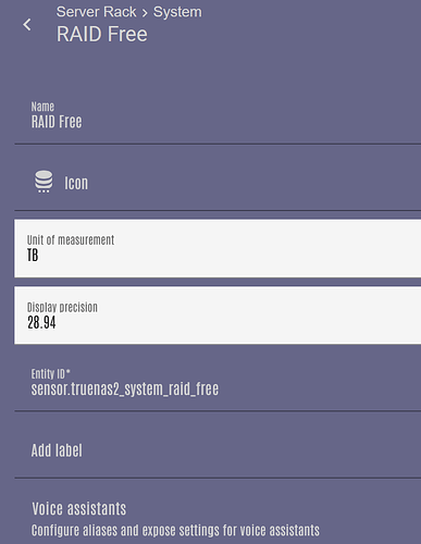

Did you have to create RAID free sensor?
No, it was one of the default sensors from the integration. I renamed it though.
