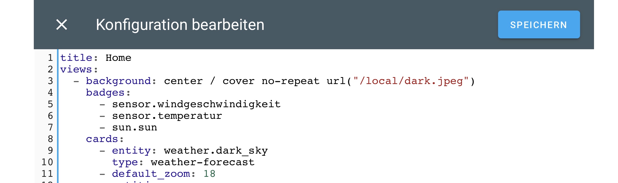

Hmmm… no success. I have a www folder in my config folder. On it an image called dark.jpg. I put this into the Lovelace editor (screenshot because c’n’p is not working on iOS)
Nothing. I tried with "/local/www/dark.jpg" too

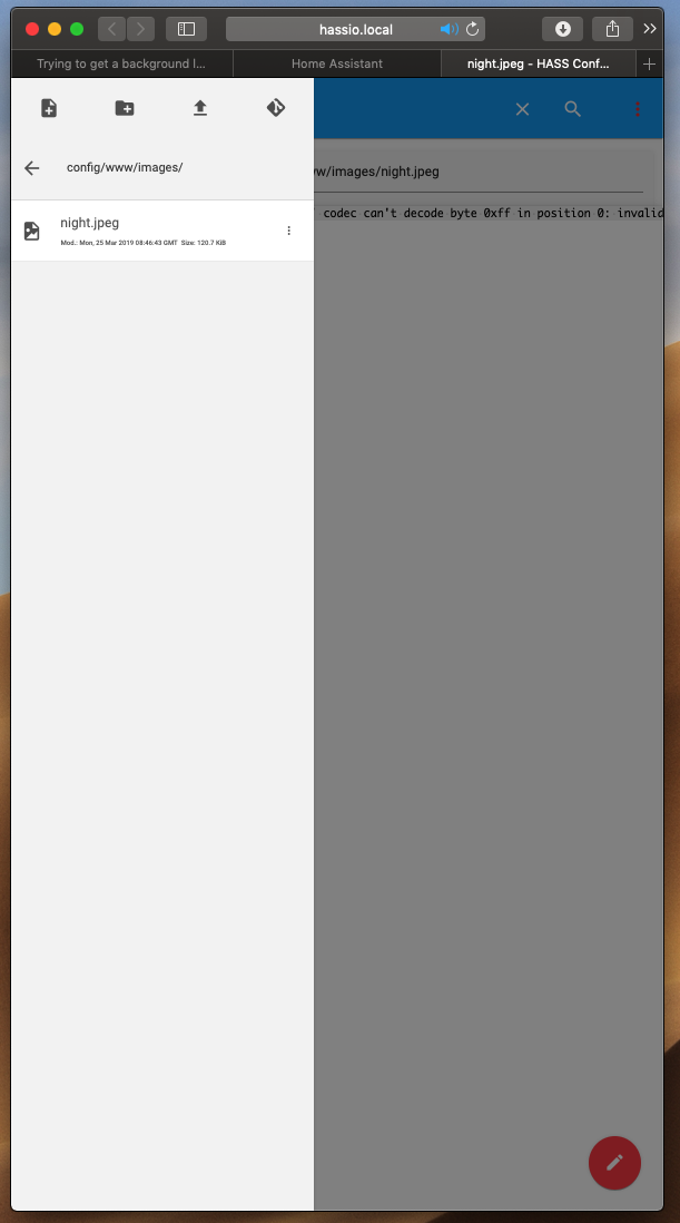

Please take a screenshot of your config folder, where configuration.yaml is located.
Not sure under HASSIO.
Under HA I originally added a background and got an error message about permissions. Set the permission on the background file to homeassistant and it worked.
That’s not needed for hassio. Don’t have the ability to change permissions anyways in hassio.
I suppose I should ask this too, but are you clearing the cache during your refreshes? CTRL+F5
Come with me on a trip to my folders and files :slight_smile: And yes…cache is cleared.
