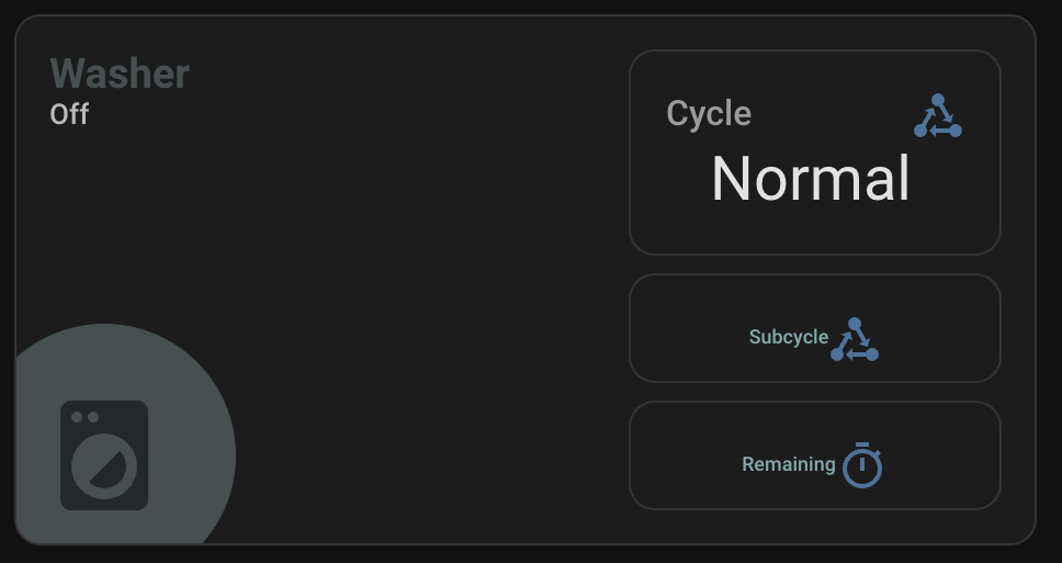

i am trying to achieve this same thing but it’s not working.
type: custom:button-card
icon: mdi:washing-machine
tap_action:
  action: navigate
  navigation_path: laundry
entity: sensor.washer_machine_state

          card_mod:
            style:
              hui-generic-entity-row $: |
                state-badge {
                  display: none;

The first card still shows the icon.
