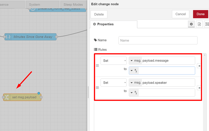

Input is
msg.payload.message - text message to speak (example: Hey, lets check the TTS queue!)
msg.payload.speaker - media entity of speaker (example: media_player.google_home_mini_livingroom)
Here is Flow
