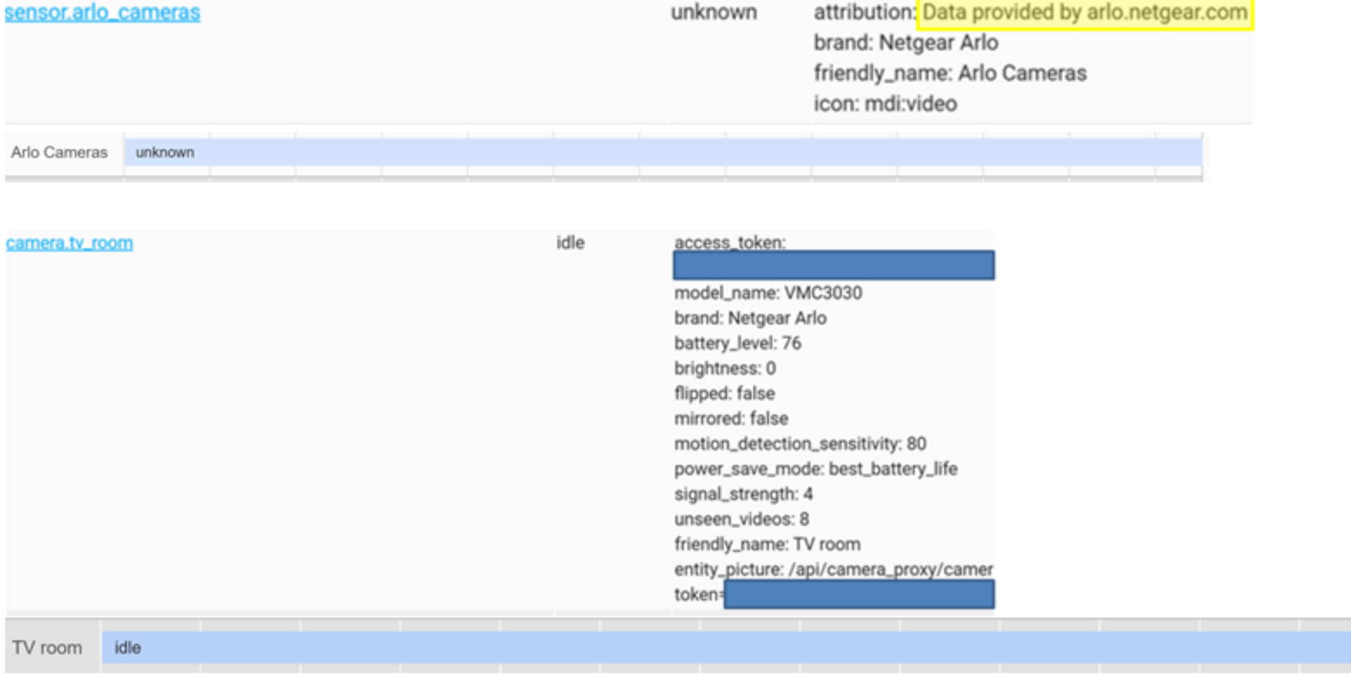

Unfortunately, I’ve been playing with this for past 10 hrs and still unsuccessful.
The arlo camera component (camera.tv_room) shows ‘idle’ . The sensor component that got auto-created (sensor.arlo_cameras) just shows ‘unknown’
During a motion trigger, none of these attributes change.
Motion detection is enabled with “camera.enable_motion_detection”
Arlo control panel is also armed_away with “alarm_control_panel.alarm_arm_away”
I get a message directly form Arlo that motion was detected, but the automation from HA doesn’t trigger.
Any clues whether i am not looking at the right places?

You’re looking in generally the right place, but it might be that there’s nothing pushed to HA when motion is detected. I don’t have Arlo so don’t know.
