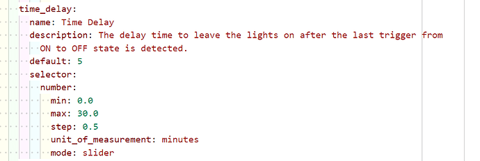

Who can show me how to edit this wonderful blueprint so I can set turn-off time in seconds instead of minutes?
Even if i am new to blue prints, that should be an easy task. First i would create a copy of the blue print. How to do that depends on your setup.
Then open the blueprint. I use the Studio Code Server plugin to access the files. You will find the blueprint in the blueprints folder and there in the subfolder Blackshome
Open the Yaml and look for turn off time like this example
As you can see there is an optin “unit_of_measurement”. Just change it to seconds
Save and thats it.
