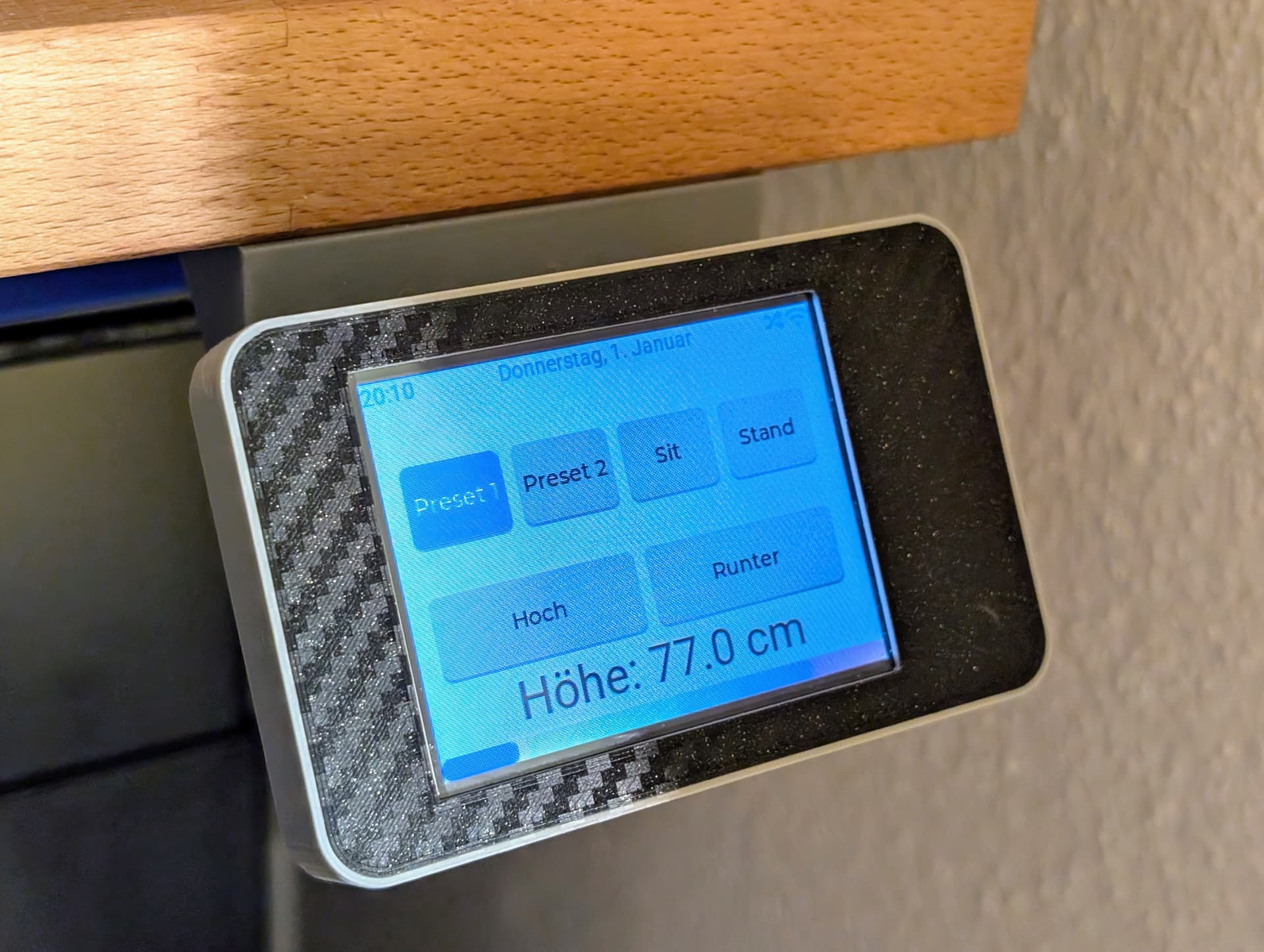

Hey @imick thanks once more for this amazing project!
I found a mount on MakerWorld by Adrian, so in case anybody tries to have both the Home Assistant-enabled controls, but also some sort of touch control, this might be an idea.:
So both of your ideas (controlling HA-entities with a display, but also your Loctek-Implementation brought me to this combination of both lovely projects)
Thanks for the nice work,
I created a minimalistic housing for that solution.
https://makerworld.com/de/models/1315658-d1-mini-c3-rj-45-enclosure

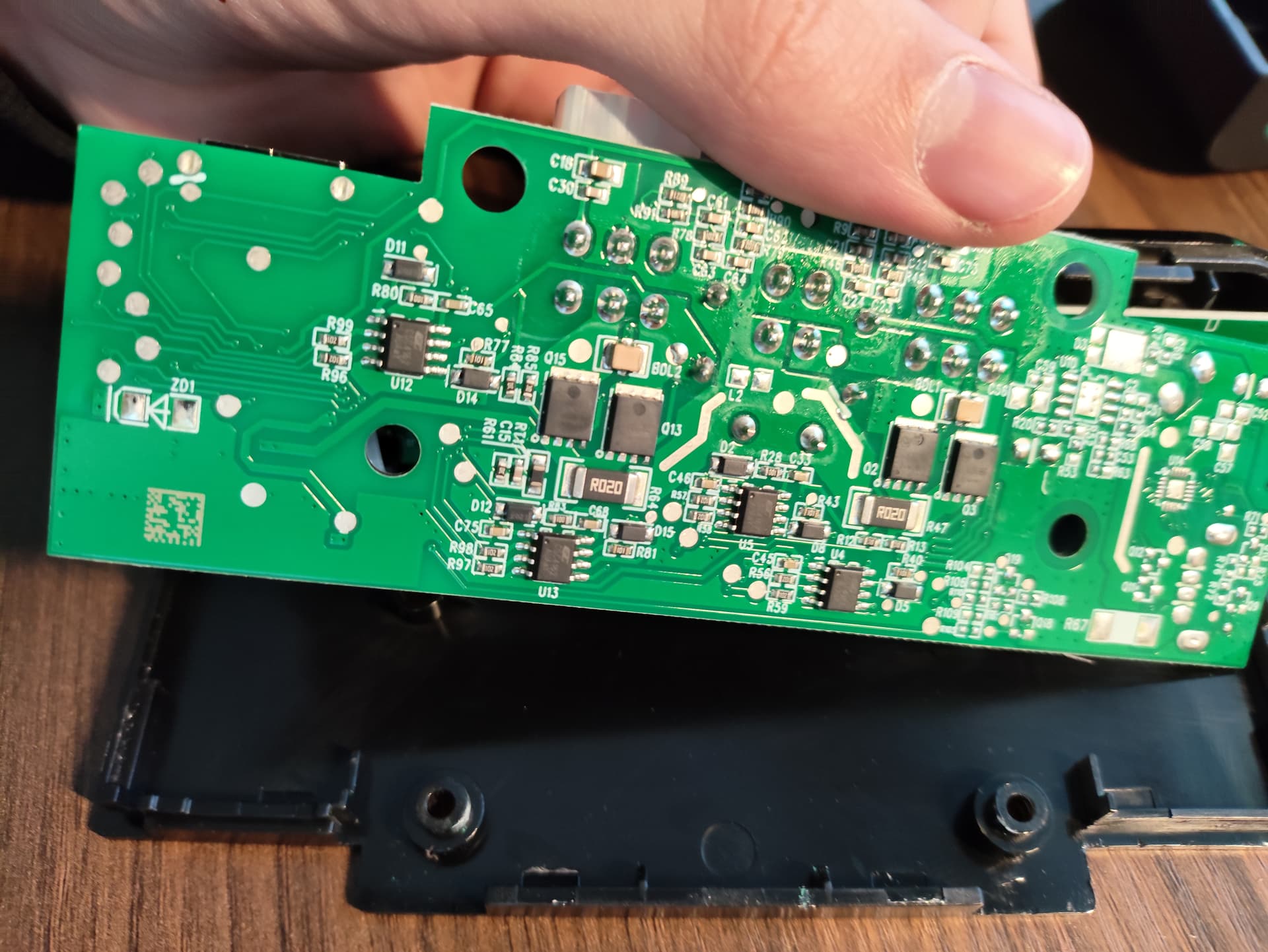

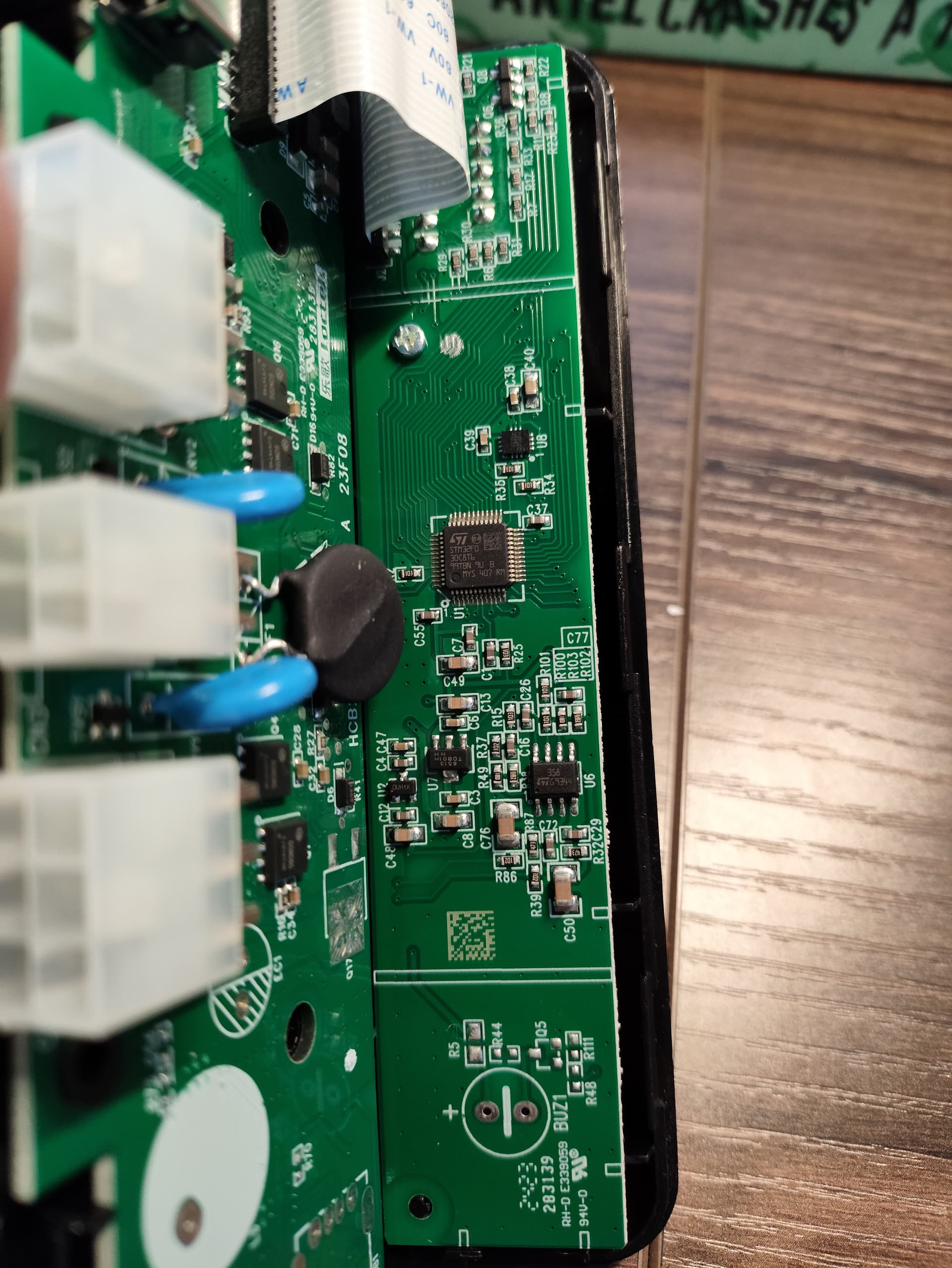

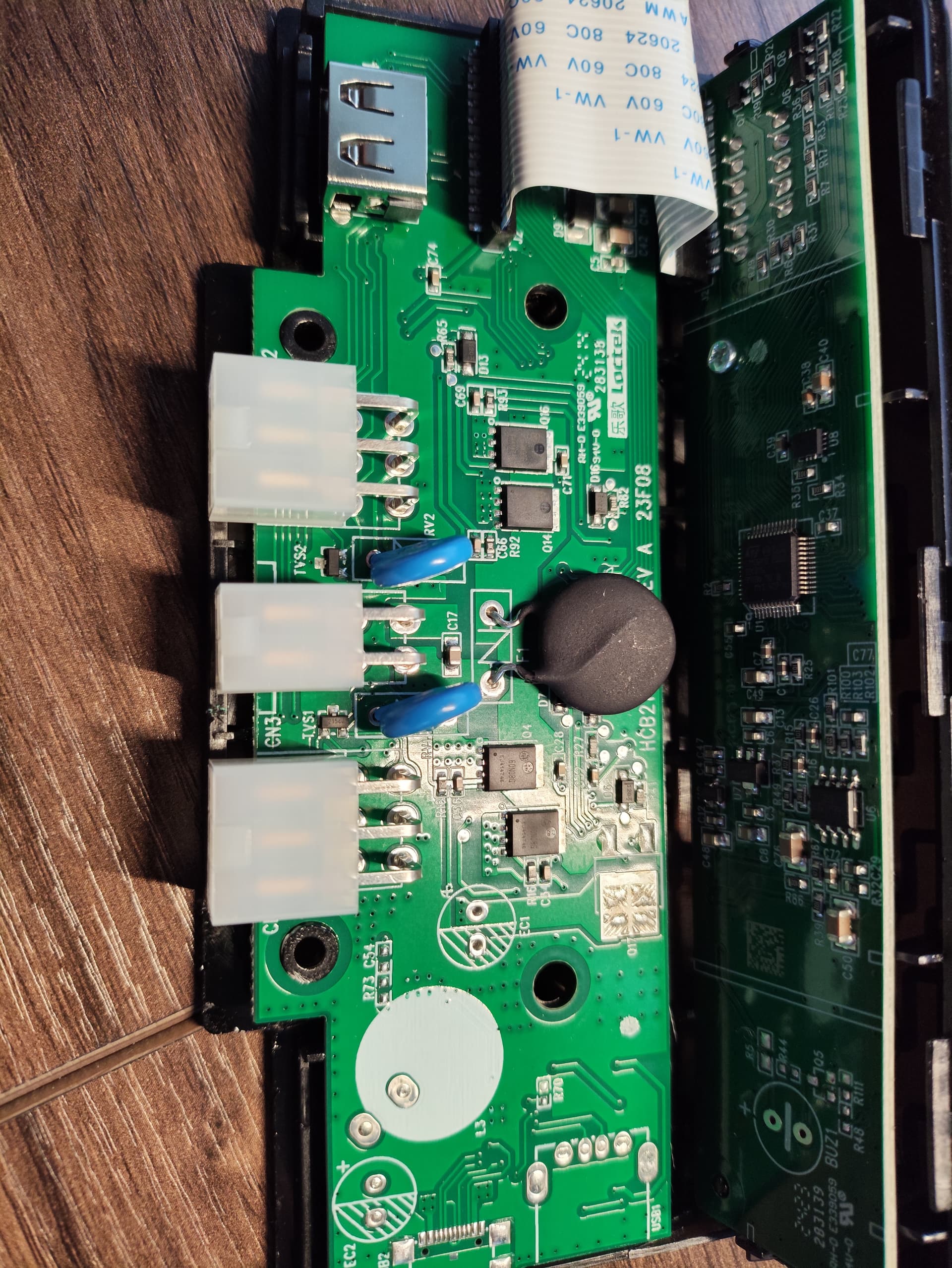

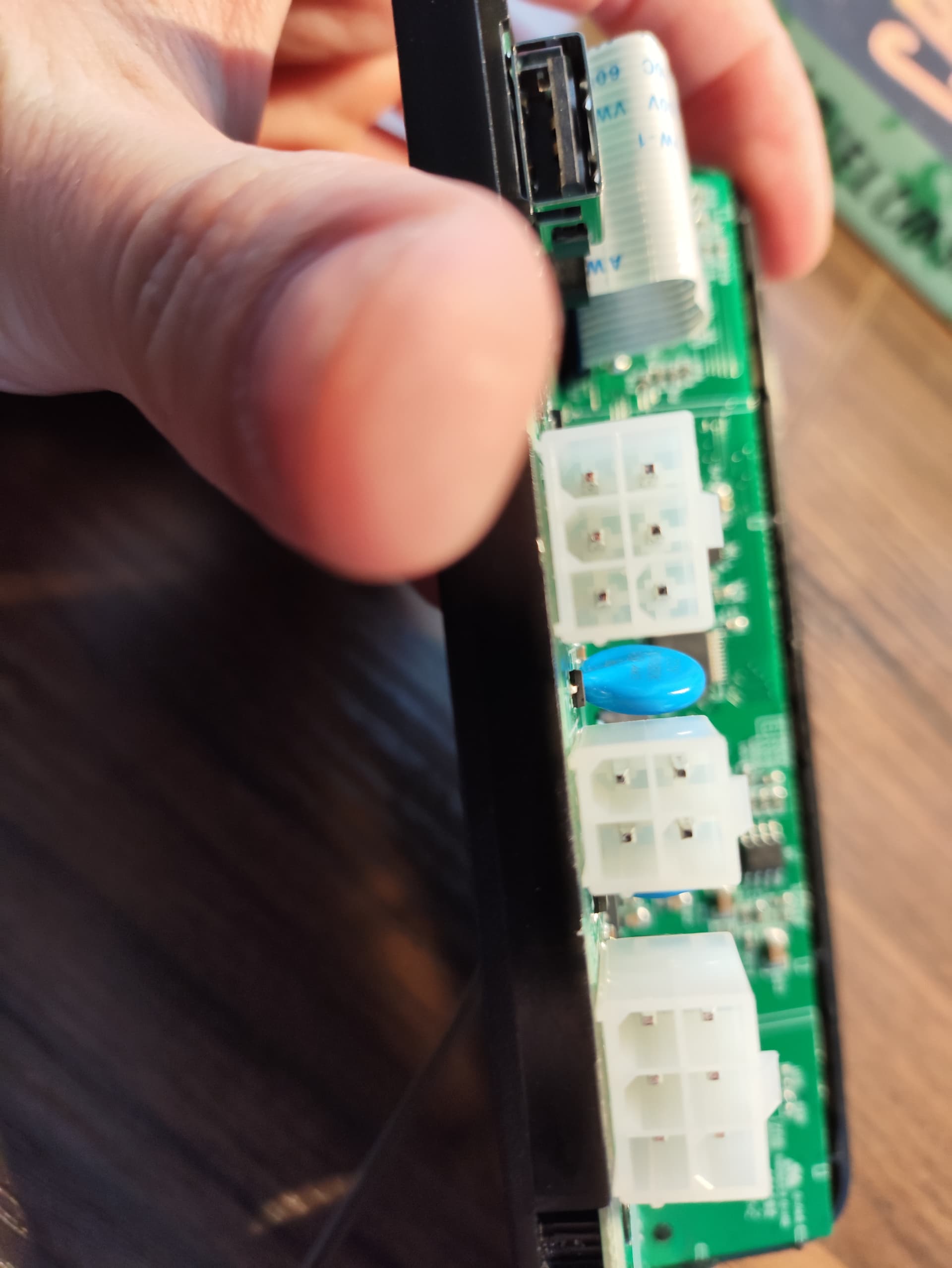

I have a Flexiapo E5 Lite Desk with a control unit, and I’m looking for ideas on how to wire it for integration into Home Assistant using ESPHome. My goal is to be able to automate and control the desk’s height and functionality.
I’ve attached pictures of both the desk and control unit to give you a better idea of how things are set up.
If anyone has experience wiring similar devices or using ESPHome with adjustable desks, I’d appreciate your suggestions on how to wire the desk for seamless integration with Home Assistant.
