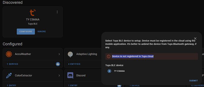

Select Tuya BLE device to setup. Device must be registered in the cloud using the mobile application. It’s better to unbind the device from Tuya Bluetooth gateway, if any.
Device is not registered in Tuya cloud
Tuya BLE device
TY 799940

tried removing from smart link app too, same issue
