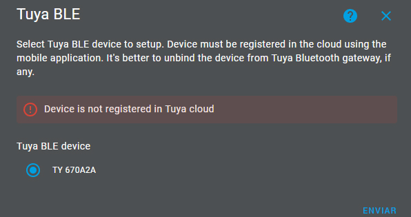

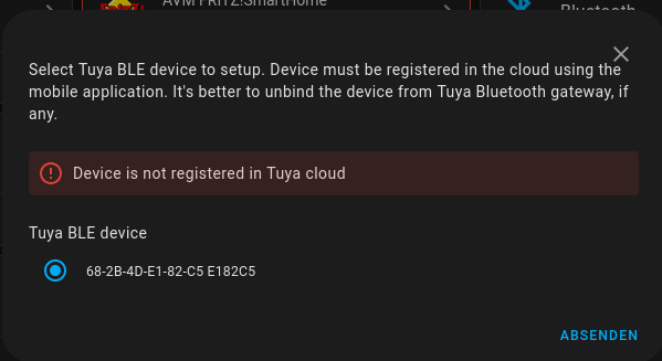

My smart door locks are discovered by TuyaBle, however I get this error even though they are online and registered at Tuya cloud. Any comment how to resolve this issue?

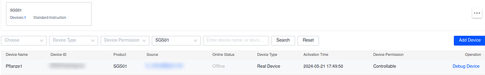

Tuya iot platform project - resources added
device (standard instructions)
smart life app
after connecting with api key (first time)
second attempt - address changed
Temp and hum / battery state in smart life app looking good to me.
Do i miss something obvious?
