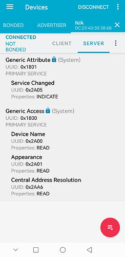

Trying connecting in the nRF app, if you could send a screenshot of the services on the device that would be great. For reference here is an example (note, I’m not home, this is just some random device that popped up so it will look different, but it should be under the same menus)
Tuya Smart app device information:
nRF Connect:
Scanner tab:
Client tab
Server tab:
Thanks, ok, that’s a shame. It looks like the protocol implemented in the TYBT4L is different to what is implemented in the Tuya BLE integration. Unfortunately I can’t find a lot of info about that module online apart from the usual datasheets, but pin 15+16 is a serial UART (RX/TX), if that is connected to something on the board it probably communicates to an MCU which if so you can replace the Bluetooth chip with a esphome compatible chip instead.
