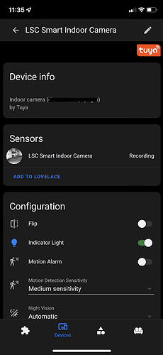

I recently bought a Tuya camera (subbranded as LSC Smart Connect) that is correctly picked up by the official Tuya integration recently release by HA core. However, this camera seems to be recognized, shows me a correct thumbnail/snapshot for the camera but no live stream when I open the camera entity.
Anybody else encountering this issue with Tuya cams? The docs say they should be officially supported by the integration, and I guess I have Tuya integration set up correctly together with my Tuya IoT platform app.
