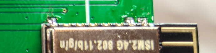

3 second search for “WB3S” reveals:
So no ESP means no Tasmota or vanilla ESPHome but you can try LibreTuya which has a ESPHome :fork_and_knife:
https://docs.libretuya.ml/docs/projects/esphome/
https://docs.libretuya.ml/boards/wb3s/
