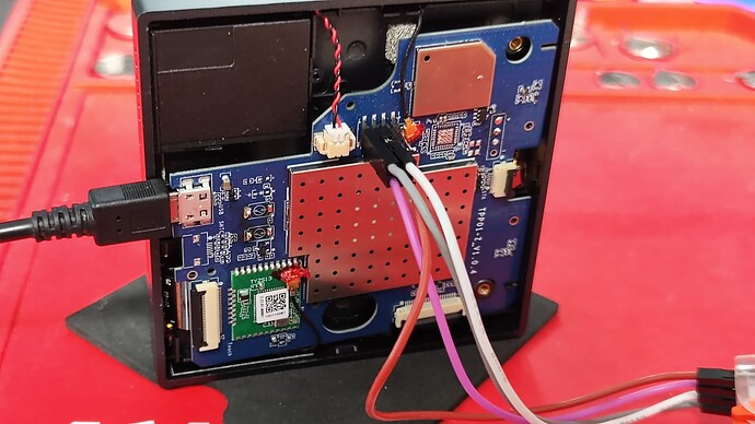

Thanks for all the help @yabdali!! Sadly, I still can’t get passed the initial issue of not being able to switch it into the loader mode, or any mode that allows me to flash it… The issue is the same as I posted above, even with newer versions of the tool:
  1. I open the tool, it detects an “ADB” device.
  2. I click “Switch”, the device reboots but gets unresponsive / is not detected anymore / gets stuck in that screen:
I hooked it up to external power supply, yes. Not via the 230V backplate, because then I can’t access the USB anymore. But to my bench PSU, providing the 5V that the backplate would also provide, so no change really:
It seems that something is missing to make it enter any of those boot modes…
[EDIT]
I just made the effort to use a Dremel an modify the case so I can connect have the ribbon cables connect while connecting the USB cable, just for the minimal super slight chance that it doesn’t continue booting because of these… But no change: After hitting “Switch”, it’s just not showing up anymore…
Also, where did you get those two screenshots from and which tool does it reference? I have a couple of versions now of the “RKDevTool” (or “AndroidTool”) and none of them offer options to switch the device specifically into these Android boot modes :confused: It always only has the “Switch” button to switch it to “RockUSB” mode

I also tried “adb reboot bootloader” which works, but again: It makes the device reboot and go into that screen below and neither “adb devices” will list it, nor does the “RkDevelopTool” or “AndroidTool” see it anymore… It’s just gone / unresponsive. So I don’t know how I would be able to flash anything to it in that state :frowning:
When you use “adb reboot bootloader” do you see any new device/drivers in your Windows Device Manager?
Nope, not seeing any rockusb devices or anything else suspicious. Also nothing under “other devices” or anywhere else I think it could be :frowning:
I obviously do see an Android ADB interface device before I do “adb reboot bootloader”, but after I do it it also disappears / gets hidden, as you can see :frowning:
THX AGAIN at this point for your tremendous effort / help here!!!

@ezcGman I believe I have the exact same device as yours. FYI I was able to dump the firmware with these steps (I’m using Linux):
  1. Let the panel boot normally with USB connected to computer
  2. Run “adb reboot bootloader”: my panel shows the Moes logo which is where I bought it from, and is stuck in this state
  3. From my computer, rkdevtool now shows:
tasty@TASTY-MINT:~/Projects/rkdeveloptool$ ./rkdeveloptool  ld
DevNo=1	Vid=0x2207,Pid=0x330d,LocationID=102	Loader
  1. Dump the firmware:
tasty@TASTY-MINT:~/Projects/rkdeveloptool$ ./rkdeveloptool rfi
Flash Info:
	Manufacturer: SAMSUNG, value=00
	Flash Size: 218 MB
	Flash Size: 447488 Sectors
	Block Size: 512 KB
	Page Size: 2 KB
	ECC Bits: 0
	Access Time: 40
	Flash CS: Flash<0>
tasty@TASTY-MINT:~/Projects/rkdeveloptool$ sudo ./rkdeveloptool rl 0 447488 backup.bin
Read LBA to file (100%)
tasty@TASTY-MINT:~/Projects/rkdeveloptool$ ls -lh backup.bin
-rw-r--r-- 1 root root 219M Mar 10 13:56 backup.bin
Now I gotta find a way to modify the firmware to allow adb in normal mode so I can sideload apps to it. Will let you know if I find anything.

I tried reflashing my panel with the dump I extracted earlier just to make sure I can revert to stock firmware in case flashing another firmware doesn’t work.
Unfortunately the panel doesn’t boot anymore and is stuck in Maskrom mode. rkdeveloptool does not allow me to write firmware anymore in this mode so I gotta find a way to fix that issue first before trying @mattmon dump.
