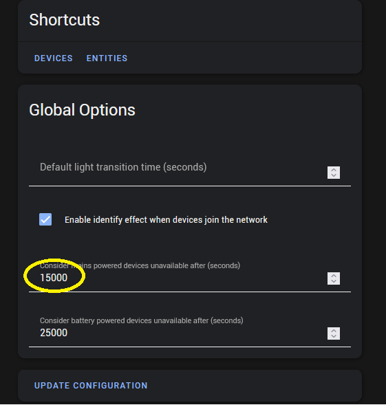

One thing you can try.
Select Configure on the ZHA integration and increase the time before your device becomes unavailable. Then, Update Configuration.
It helped with 2 of my sockets because originally it was a lot lower.

Increased the offline timeout and repaired the devices. They are still turning off.
