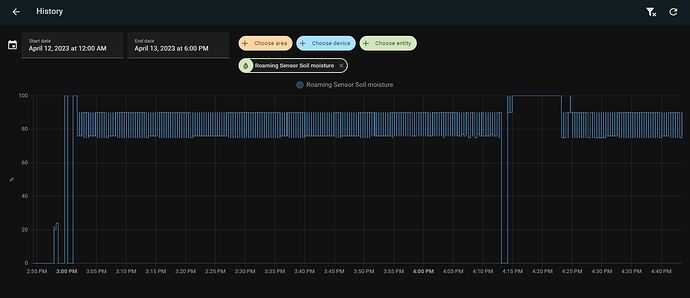

Hello, I am also having this issue. Soil moisture updating every few seconds for me also bouncing between 75% and 90%.
I am new to HA, but would be glad to provide any needed information to help with diagnostics.
Another thing I noticed, which maybe be a related issue is that this sensor seems to read quite high.
I have a second sensor which is not bouncing around like this one - it is pegged reading at 100%.This is presumably why it isn’t bouncing, as I think this sensor is programmed to only push an update on some large x% swing in detected moisture, however another different branded sensor I have sitting next to it reads around 80%, which intuitively seems much closer to the moisture in the soil than 100%.
The two areas of investigation to me seem to be around the reporting behavior and thresholds for pushing updates, and then it seems the sensor itself is reading high. Hopefully these can both be rectified with software changes rather than being side effects of the physical design.

It is good to know you are having issues with z2mqtt also. I’m integrated via ZHA so this makes me think it might either be an issue with the hardware or perhaps the base integration algorithms for soil sensors isn’t as mature as it could be given how few of these sensors there seem to be.
I have set up statistical graph cards to view the output only showing the mean, and it does seem to produce a plausible graph which gives me some hope that the hardware is actually capable of producing accurate enough results.
It almost seems like the onboard firmware on the sensor should itself be averaging its readings over a specified amount of time, say 1 minute minimum and then only activating the radio early to push an update if the swing is over say 10%. Instead it seems to almost be dumping it’s raw sensor feed directly into HA, which is insane for a battery device.
Attached is an arbitrary 5 minute graph showing dozens of readings.

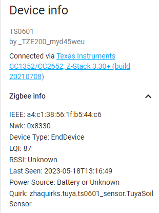

Don’t give up! I’m playing with the same sensor for over month already - it is robust for me and shows plausible values for both plant moisture and temperature.
Connected over ZHA.
Interestingly, the second device connected over zigbee2mqtt is not recognized at all (addon to HA):
Zigbee2MQTT version
1.30.4 commit: unknown

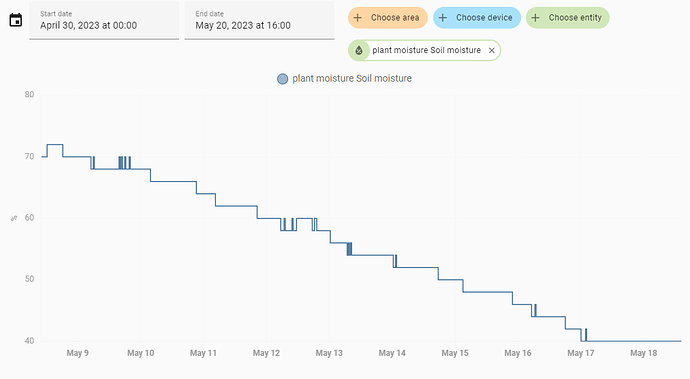

There are hardware variants of the ts0601_soil sensor, where the new version appears to have addressed the faults experienced with the earlier version.
I have both the old and new versions. The early versions were not fit for purpose for me but I’m pleased to report that I have experienced positive results with the updated sensor.

My understanding is these sensors cannot have their firmware updated remotely, but the new hardware version fixes the issues I experienced and have so far been reliable for me.
