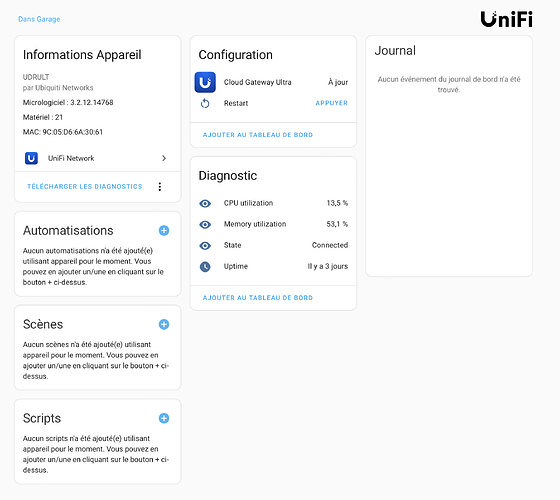

I downloaded 2024.5, what do I need to do to have Rx/Tx for my Unifi devices? I have a UCG-Ultra and USW-Enterprise-8-POE.
