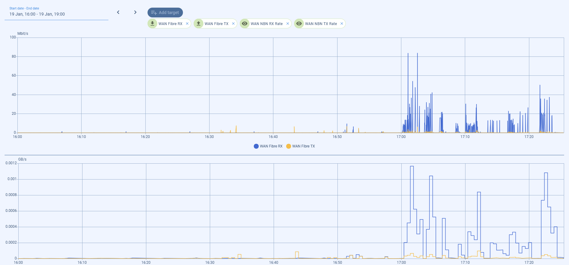

My ISP comes in on eth4 with vlan 6 and pppoe (port 5)
So ive tried in and out octets from eth4, eth4.6 and even ppp0
None of them seem to work with your coding? (getting no change in graph or anything)
Am i missing something?

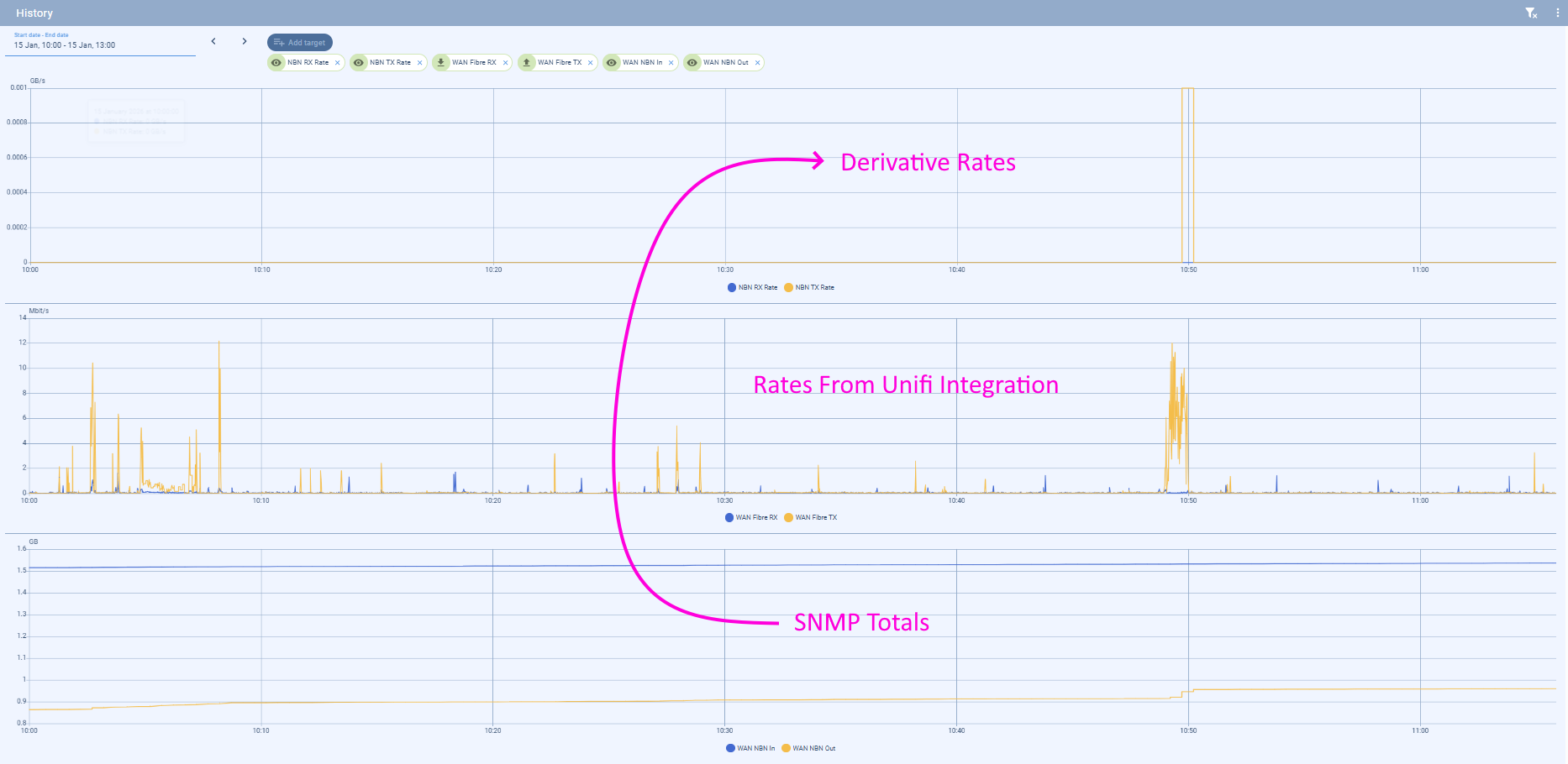

Try an SNMP tool to check if the values are changing while doing a speed test or a modest download of sorts. We first need to confirm that you have valid data and for which OID.
It seems that ppp works. ill circle back :smiley:
Edit:
it does

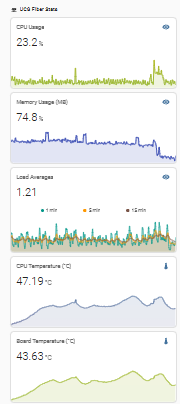

    host: 192.168.1.1
    community: public
    baseoid: 1.3.6.1.4.1.41112.1.10.1.1.7.1
    unit_of_measurement: "%"
    value_template: "{{ value | float }}"
  - platform: snmp
    host: 192.168.1.1
    community: public
    baseoid: 1.3.6.1.4.1.41112.1.10.1.1.9.1
    unit_of_measurement: "MB"
    value_template: "{{ (value | int / 1024 / 1024) | round(1) }}"
  - platform: snmp
    host: 192.168.1.1
    community: public
    baseoid: 1.3.6.1.4.1.41112.1.10.1.1.10.1
  - platform: snmp
    name: "Board Temperature"
    host: 192.168.1.1
    community: public
    baseoid: 1.3.6.1.4.1.41112.1.10.1.1.8.1
    unit_of_measurement: "°C"
  - platform: snmp
    host: 192.168.1.1
    community: public
    baseoid: 1.3.6.1.2.1.1.3.0
    value_template: >-
      {% set ticks = value | int %}
      {% set seconds = ticks // 100 %}
      {% set minutes = (seconds // 60) %}
      {% set hours = (minutes // 60) %}
      {% set days = (hours // 24) %}
      {{ days }}d {{ hours % 24 }}h {{ minutes % 60 }}m {{ seconds % 60 }}s
  - platform: snmp
    name: "Load Average 1min"
    host: 192.168.1.1
    community: public
    baseoid: 1.3.6.1.4.1.2021.10.1.3.1
  - platform: snmp
    name: "Load Average 5min"
    host: 192.168.1.1
    community: public
    baseoid: 1.3.6.1.4.1.2021.10.1.3.2
  - platform: snmp
    name: "Load Average 15min"
    host: 192.168.1.1
    community: public
    baseoid: 1.3.6.1.4.1.2021.10.1.3.3

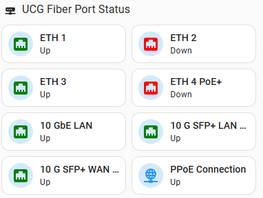

  # Physical Port Status Sensors (up=1, down=2, unknown=3)
  - platform: snmp
    host: 192.168.1.1
    community: public
    version: 2c
    baseoid: 1.3.6.1.2.1.2.2.1.8.10
    value_template: >-
      {% set s = value | int %}
      {% if s == 1 %} up {% elif s == 2 %} down {% else %} unknown {% endif %}
  - platform: snmp
    host: 192.168.1.1
    community: public
    version: 2c
    baseoid: 1.3.6.1.2.1.2.2.1.8.11
    value_template: >-
  - platform: snmp
    host: 192.168.1.1
    community: public
    version: 2c
    baseoid: 1.3.6.1.2.1.2.2.1.8.12
    value_template: >-
  - platform: snmp
    host: 192.168.1.1
    community: public
    version: 2c
    baseoid: 1.3.6.1.2.1.2.2.1.8.13
    value_template: >-
  - platform: snmp
    host: 192.168.1.1
    community: public
    version: 2c
    baseoid: 1.3.6.1.2.1.2.2.1.8.14
    value_template: >-
  - platform: snmp
    host: 192.168.1.1
    community: public
    version: 2c
    baseoid: 1.3.6.1.2.1.2.2.1.8.6
    value_template: >-
  - platform: snmp
    host: 192.168.1.1
    community: public
    version: 2c
    baseoid: 1.3.6.1.2.1.2.2.1.8.5
    value_template: >-

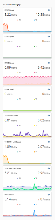

  - platform: snmp
    name: "eth0 RX Bytes"
    host: 192.168.1.1
    community: public
    baseoid: 1.3.6.1.2.1.2.2.1.10.10
    scan_interval: 10
  - platform: snmp
    name: "eth0 TX Bytes"
    host: 192.168.1.1
    community: public
    baseoid: 1.3.6.1.2.1.2.2.1.16.10
    scan_interval: 10
  - platform: snmp
    name: "eth1 RX Bytes"
    host: 192.168.1.1
    community: public
    baseoid: 1.3.6.1.2.1.2.2.1.10.11
    scan_interval: 10
  - platform: snmp
    name: "eth1 TX Bytes"
    host: 192.168.1.1
    community: public
    baseoid: 1.3.6.1.2.1.2.2.1.16.11
    scan_interval: 10
  - platform: snmp
    name: "eth2 RX Bytes"
    host: 192.168.1.1
    community: public
    baseoid: 1.3.6.1.2.1.2.2.1.10.12
    scan_interval: 10
  - platform: snmp
    name: "eth2 TX Bytes"
    host: 192.168.1.1
    community: public
    baseoid: 1.3.6.1.2.1.2.2.1.16.12
    scan_interval: 10
  - platform: snmp
    name: "eth3 RX Bytes"
    host: 192.168.1.1
    community: public
    baseoid: 1.3.6.1.2.1.2.2.1.10.13
    scan_interval: 10
  - platform: snmp
    name: "eth3 TX Bytes"
    host: 192.168.1.1
    community: public
    baseoid: 1.3.6.1.2.1.2.2.1.16.13
    scan_interval: 10
  - platform: snmp
    name: "eth4 RX Bytes"
    host: 192.168.1.1
    community: public
    baseoid: 1.3.6.1.2.1.2.2.1.10.14
    scan_interval: 10
  - platform: snmp
    name: "eth4 TX Bytes"
    host: 192.168.1.1
    community: public
    baseoid: 1.3.6.1.2.1.2.2.1.16.14
    scan_interval: 10
  - platform: snmp
    name: "eth5 RX Bytes"
    host: 192.168.1.1
    community: public
    baseoid: 1.3.6.1.2.1.2.2.1.10.6
    scan_interval: 10
  - platform: snmp
    name: "eth5 TX Bytes"
    host: 192.168.1.1
    community: public
    baseoid: 1.3.6.1.2.1.2.2.1.16.6
    scan_interval: 10
  - platform: snmp
    name: "eth6 RX Bytes"
    host: 192.168.1.1
    community: public
    baseoid: 1.3.6.1.2.1.2.2.1.10.5
    scan_interval: 10
  - platform: snmp
    name: "eth6 TX Bytes"
    host: 192.168.1.1
    community: public
    baseoid: 1.3.6.1.2.1.2.2.1.16.5
    scan_interval: 10
  - platform: snmp
    name: "ppp0 RX Bytes"
    host: 192.168.1.1
    community: public
    version: 2c
    baseoid: 1.3.6.1.2.1.2.2.1.10.31
    scan_interval: 10
  - platform: snmp
    name: "ppp0 TX Bytes"
    host: 192.168.1.1
    community: public
    version: 2c
    baseoid: 1.3.6.1.2.1.2.2.1.16.31
    scan_interval: 10

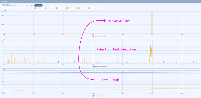

Tomorrow I’ll set up some derivatives to get the data rates then I’ll probably ditch the Unifi Networks integration. Way too much overhead as this is pretty much all I use.
Hmm. Derivative of the total bytes sensor is not adequate. I was expecting less resolution (1 minute average) but not this bad:
EDIT: Fixed it. Just had to up the derivative precision (rounding):
- platform: snmp
  name: 'WAN NBN In'
  unique_id: 93116c62-4d47-4a5e-a6f3-6bb7e3ae95f3
  host: 10.1.1.1
  baseoid: 1.3.6.1.2.1.2.2.1.10.5 # eth4 / port 5 in
  community: 'public'
  version: '2c'
  scan_interval: 30
  unit_of_measurement: GB
  value_template: "{{ value|int /1000000000 }}"
- platform: derivative
  unique_id: 91c0ca53-9965-43e2-99d7-b0bd8420287a
  name: WAN NBN RX Rate
  source: sensor.wan_nbn_in
  round: 6 # <- THIS
  unit_time: s
Just needs a bit of scaling with a template sensor becuase the derivative sensor does not support a value_template.
Still way less data being stored. this is what the unifi tx/rx 2 second update was doing to my db in the last few days:
