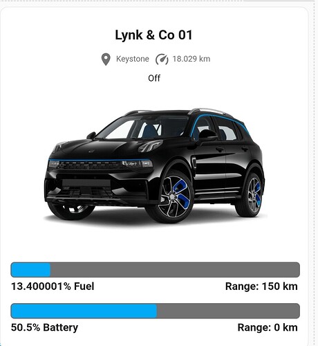

When adding a hybrid vehicle, the fuel amount is displayed in % instead of liters. How can I change that?
Anyone? It’s quite annoying to have a full tank of 60 liters and it’s showing 60% full.
same issue here with liters shown as percentage

The gauges only use sensors with percentage BUT you could make a helper sensor that converts the math to make it percentage. We had a user in our Discord that did that.

Exactly. Just create a template helper with the following code:
{{ states(‘sensor.yourcar_fuel_level’) | float / 71 * 100 | round(0) }}
Where 71 one is the full capacity of my tank
