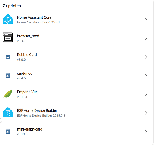

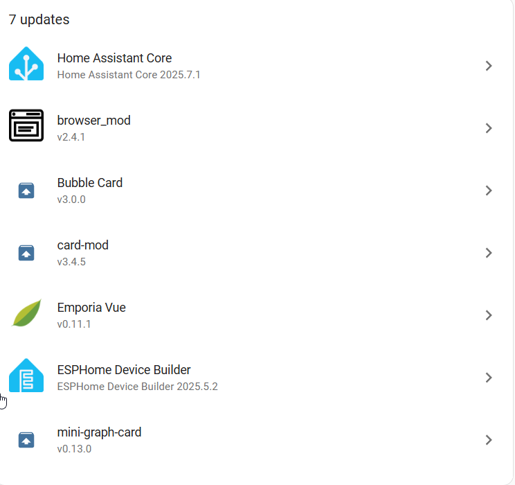

These are the upgrades I need, I will eventually try and do some testing by upgrading each item 1 by 1 and see if I can launch the android app after they are upgrade to see which one breaks it.

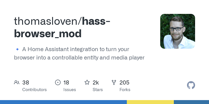

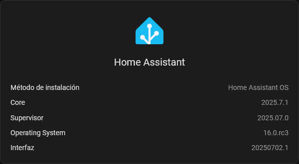

im on 2025.7.1 without a problem what does the browser_mod do?
edit
After restarting Home Assistant, all Browsers will need a reload to download the latest version of Browser Mod javascript file. Version 2.4.0 includes a notification when a Browser version mismatch is detected, so from 2.4.x onwards simply clicking Reload should be sufficient. If you keep getting the notification, you may need to do a hard Browser reload SHIFT+F5 or in some cases clear your Browser cache.
i think this is the cause of all your problems

Will try upgrading Assistant core and see if It works.
