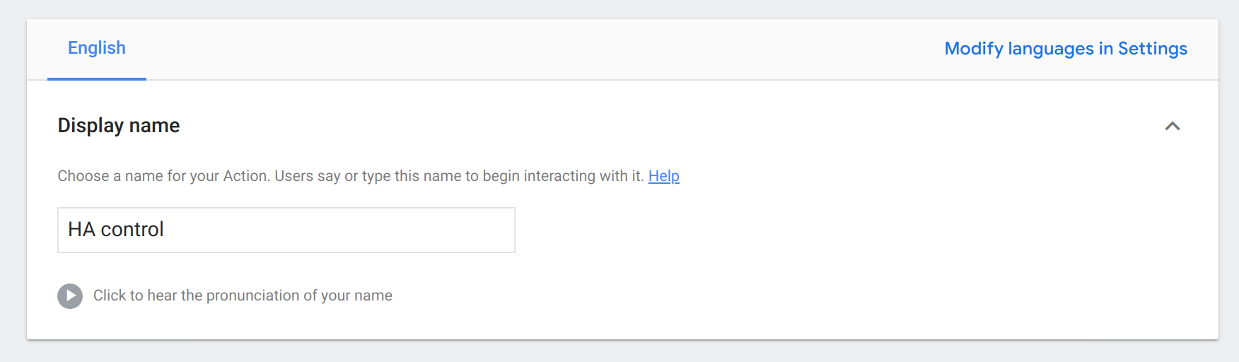

  2. I gave a name for the action (at ‘Invocations’ menu point):
