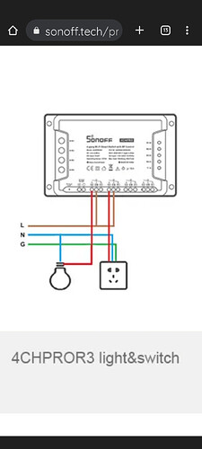

Have you tried continuity checking the sonoff?
Edit:
According to this image it seems you should connect live on the common and one of the wires of the actuators to NO/NC.
Then the other actuator cable to neutral.
I didn’t know it had dry contacts…
Well thanks again! :slight_smile:
