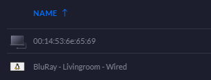

I thought that the integration was supposed to remove devices from HA if they have been removed from the unifi system.
I have a couple of device tracker entities that were added automatically to HA but there is no device associated with them and the devices themselves have been removed from the unifi controller.
Is that the way it’s supposed to work?
this is the only device that has the MAC as the name in the controller:
but here are the two device trackers that exist in HA:
Ironically the first device in the controller from the first pic doesn’t actually show up in HA so it’s pretty inconsistent in both directions.
is there a reason why they haven’t been deleted from the integration?
