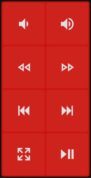

I made 4 cards for the remotes I use the most which I’ll toss these here in case anyone is interested.
Hopefully other people will find them useful or inspiring. Feel free to repurpose and share.
(These cards require lovelace-card-mod)
PotPlayer
2023-05-29 17 21 07 (3)

YouTube Web
type: custom:mod-card
card:
  type: vertical-stack
    - square: true
      type: grid
        - type: custom:button-card
          entity: ''
          tap_action:
            action: call-service
            service: unified_remote.call
            service_data:
              target: 192.168.2.17
              remote_id: Unified.YouTubeWeb
              action: volume_down
          icon: mdi:volume-medium
          show_icon: true
          show_state: true
          card_mod:
            style: |
              ha-card {
                border: none;
                background-color: #ffffff10;
                box-shadow: none;
                margin: 0;
                width: 100% !important;
                height: 100%;
                position: relative;
                top: 50%;
                left: 50%;
                transform: translate(-50%, -50%);
          entity: ''
          tap_action:
            service_data:
              action: volume_up
          icon: mdi:volume-high
          show_icon: true
          show_state: true
          card_mod:
            style: |
              ha-card {
                border: none;
                box-shadow: none;
                margin: 0;
                height: 100%;
                position: relative;
                top: 50%;
                left: 50%;
      columns: 2
    - square: true
      type: grid
          entity: ''
          tap_action:
            service_data:
              action: rewind
          icon: mdi:rewind-outline
          show_icon: true
          show_state: true
          card_mod:
            style: |
              ha-card {
                border: none;
                box-shadow: none;
                height: 100%;
                position: relative;
                top: 50%;
                left: 50%;
          entity: ''
          tap_action:
            service_data:
              action: fast_forward
          icon: mdi:fast-forward-outline
          show_icon: true
          show_state: true
          card_mod:
            style: |
              ha-card {
                border: none;
                box-shadow: none;
                height: 100%;
                position: relative;
                top: 50%;
                left: 50%;
      columns: 2
    - square: true
      type: grid
          entity: ''
          tap_action:
            service_data:
              action: previous
          icon: mdi:skip-backward
          show_icon: true
          show_state: true
          card_mod:
            style: |
              ha-card {
                border: none;
                box-shadow: none;
                margin: 0;
                height: 100%;
                position: relative;
                top: 50%;
                left: 50%;
          entity: ''
          tap_action:
            service_data:
              action: next
          icon: mdi:skip-forward
          show_icon: true
          show_state: true
          card_mod:
            style: |
              ha-card {
                border: none;
                box-shadow: none;
                margin: 0;
                height: 100%;
                position: relative;
                top: 50%;
                left: 50%;
      columns: 2
    - square: true
      type: grid
          entity: ''
          tap_action:
            service_data:
              action: fullscreen
          icon: mdi:arrow-expand-all
          show_icon: true
          show_state: true
          card_mod:
            style: |
              ha-card {
                border: none;
                box-shadow: none;
                margin: 0;
                height: 100%;
                position: relative;
                top: 50%;
                left: 50%;
          entity: ''
          tap_action:
            service_data:
              action: play_pause
          icon: mdi:play-pause
          show_icon: true
          show_state: true
          card_mod:
            style: |
              ha-card {
                border: none;
                box-shadow: none;
                margin: 0;
                height: 100%;
                position: relative;
                top: 50%;
                left: 50%;
      columns: 2
card_mod:
  style: |
    ha-card {
      background: #d41a1a;
      border: none;
      padding: 8px
