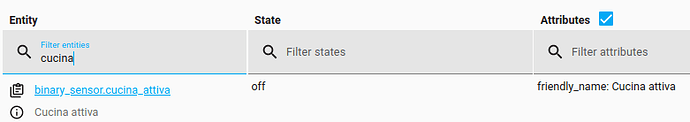

It seems to works when at least one entity become Active but refuses to goes Off when all same entitites goes Off.
I tested the “{%…%}” in the Developer Model section and it works well following the behaviour I’m expecting.
I tried just leaving only one Switch inside that Group but nothing has changed.
I also added a “fake” attribute that changes state at every trigger but it doesn’t change its state when all group entities goes Off.
