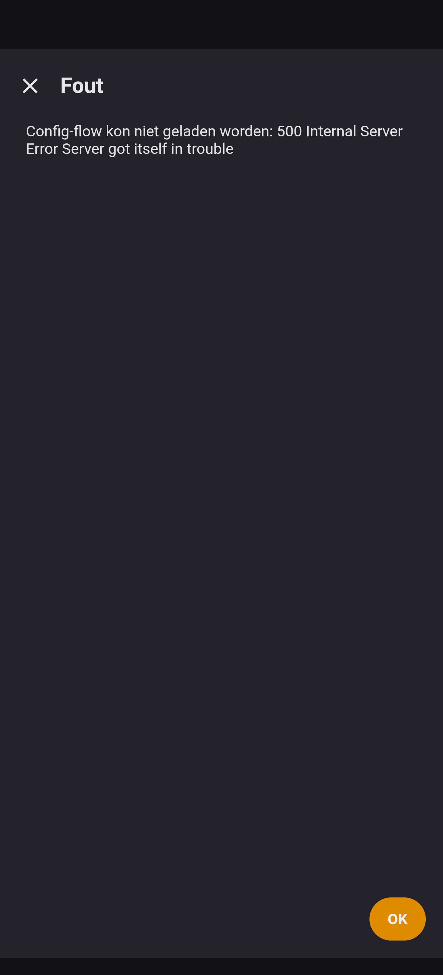

By reconfiguring i got a error
Tomorrow i gonna check how to get wifi woking with the key, and the ble option by my esphome network and report back! Thanks
Thanks, that was a real integration bug.
I pushed a fix to main:
  • added a proper Home Assistant reconfigure flow
  • hardened form defaults so old/partial entries do not crash the config flow with a 500 error
  • reconfigure now reloads the integration after saving
Commit: e7438be
Could you test current main again? If it works on your side too, I’ll cut a v0.2.2 patch release for HACS.
Now it works perfect, ty!
