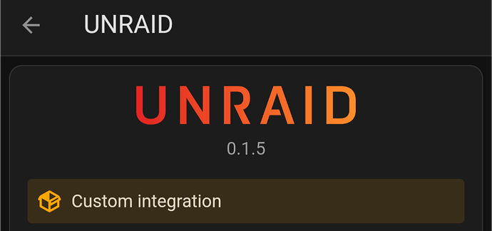

I’m not seeing any notice of integration updates in HA. So based on your comment above, I went ahead and deleted the Unraid integration and re-added it.
However the version is the same 0.1.5
Please advise…?

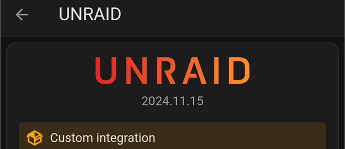

In the HA app, I deleted the integration again, went to HACS and did a ‘update information’ and then ‘redownload’ . Next I re-added the integration and it still shows the old version 0.1.5
I then noticed a prompt to restart HA.

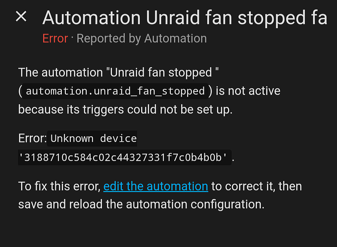

Then I received an automation error I ignored.
I went back to the integration and I now see the updated version and it is a beautiful thing! :raised_hands::heart:

The sensors you see are not valid anymore and can be removed. This is because of code updates I made.
Things like the fan binary sensor was not working correctly so I removed it until I find a proper way of detecting DC and PWM fans.
