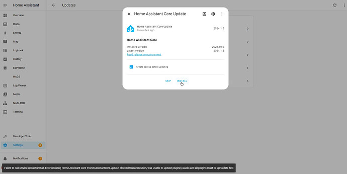

I’ve been trying to update 2023.10.2 to 2023.10.3 or 4 or 5. system does backup but that’s all.

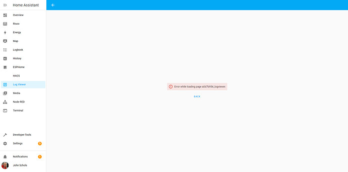

I’m just getting back to this now as have had many other things to worry about. Anyway tries updating the system from 2023.10.2 to 2024.1.5, no luck. I can’t get into any of the logs nor HACS (to update there) nor ESPHome or Logviewer or Terminal. see screen shots attached

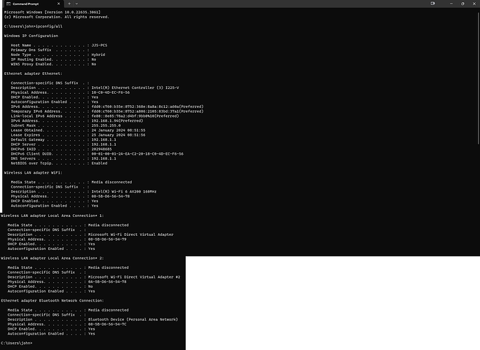

What does your supervisor status say? port 4357 instead of 8123. Also check your DNS settings.
These are the settings of your windows machine, you need to check on your home assistant installation.
And please if at all possible paste the actual text in a preformatted code block. Do not paste screenshots of text.
On a mobile device they’re way too small to read.
Also I was able to read the log enough to identify it’s probably this issue:
But I don’t know if that issue was ever solved.
