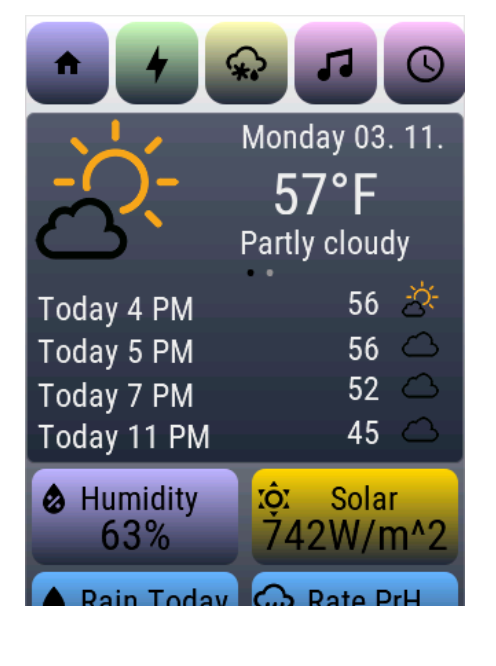

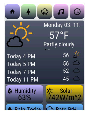

Two screen shots of the basic old way weather is shows and the new templates that will show more details of daily and or hourly weather.
Before
After

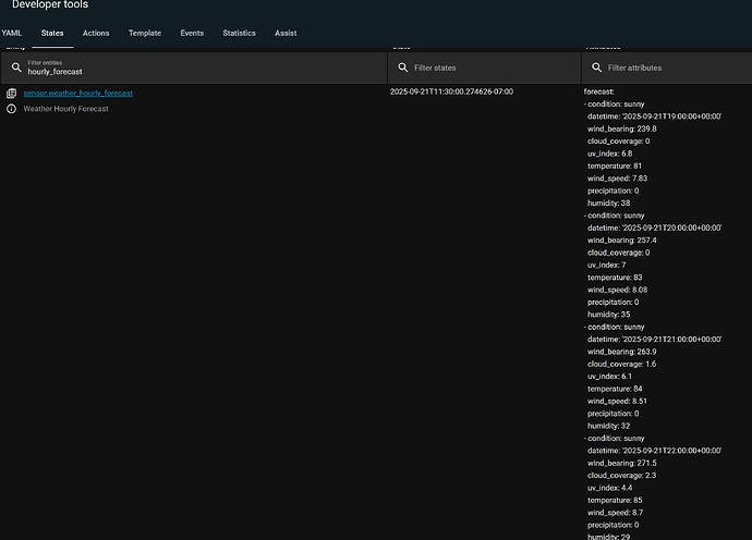

Step 1: Create the New Weather Forecast Sensors
You need to add the following code to your template.yaml file (or wherever you store your template sensor configurations). This will create two new sensors: sensor.weather_hourly_forecast and sensor.weather_daily_forecast.
Important: In the code below, you must replace weather.home with the actual name of your weather entity (e.g., weather.accuweather if yours is working, or weather.home if you are using Met.no). You can find your entity ID in Settings > Devices & Services > Entities.
Add this code to your template.yaml file
yaml
# Sensor to fetch and store the HOURLY weather forecast
- trigger:
    - platform: time_pattern
      minutes: "/30" # Update every 30 minutes
    - platform: homeassistant
      event: start
  action:
    - service: weather.get_forecasts
        type: hourly
        entity_id: weather.home # <-- CHANGE THIS to your weather entity
      response_variable: hourly
  sensor:
    - name: "Weather Hourly Forecast"
      unique_id: weather_hourly_forecast
      state: "{{ now().isoformat() }}"
      attributes:
        forecast: "{{ hourly['weather.home'].forecast }}" # <-- CHANGE THIS to match

Understanding the Forecast: forecast[0], forecast[1], etc.
A common point of confusion is how to get the forecast for a specific hour or day. The forecast attribute is a list, and in programming, lists always start counting from zero.
Hourly Forecast (sensor.weather_hourly_forecast)
  • forecast[0] = The current hour
  • forecast[1] = 1 hour from now
  • forecast[2] = 2 hours from now
  • …and so on.
Daily Forecast (sensor.weather_daily_forecast)
  • forecast[0] = Today
  • forecast[1] = Tomorrow
  • forecast[2] = The day after tomorrow
  • …and so on.

Step 2: Update Your openHASP Configuration
Now, you need to edit your openhasp.yaml file to tell your display to get its forecast data from these new sensors. You will need to find all the objects related to your weather page and change the templates.
Example for an hourly forecast object:
  • OLD CODE:
    - obj: "p5b22" # Forecast temp +1h
      properties:
        "text": "{{ state_attr('weather.home','forecast')[1]['temperature'] }}"
  • NEW CODE:
      properties:
        "text": "{{ state_attr('sensor.weather_hourly_forecast','forecast')[1].temperature }}"
Example for a daily forecast object:
  • OLD CODE:
    - obj: "p5b63" # Forecast temp max +1d
      properties:
  • NEW CODE:
      properties:
        "text": "{{ state_attr('sensor.weather_daily_forecast','forecast')[1].temperature }}"
