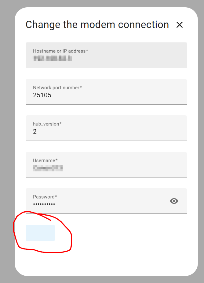

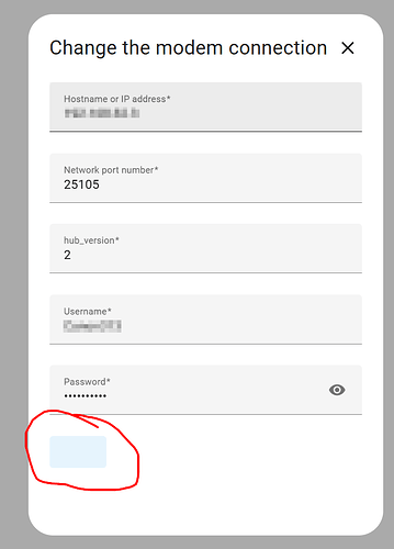

I found this image in this post in these forums. I can’t find it, anyone know where to find this IP address input field?
I think it should be in here but this “Change the modem connection” button doesn’t do anything.

Did the dialog appear to let you change the IP address? There isn’t a Save/Update/OK button visible, but I pressed Tab a few times to move between the fields and there is a hidden button after the last field! When that is highlighted, press Enter and the IP address will be saved!
I was able to find the hidden button, but it actually save? My IP address seems to be ‘stuck’ and unchangeable.
If ENTER doesn’t work, try SPACE.
Was able to change the IP address GREAT!!!
That did the trick. You’re a life saver.
