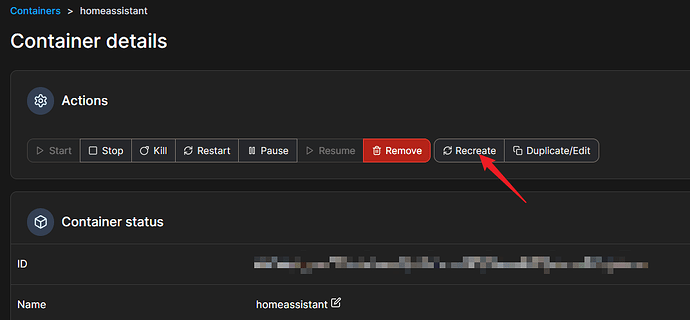

also I really recommend looking into and installing Portainer. It is installed in a docker container as well and simplifies a lot of things you normally do with docker.
For example, to update home assistant all I do is open the container in Portainer and click on ‘recreate’. there is a check box there asking if you want to pull the latest image. then click recreate.
it will download the latest image, stop the container and restart the container using that image.
literally, 5 clicks.

brilliant, i installed Portainer following these instructions:
logged into the web interface and followed your instructions:
then re-create with latest image
thank you both for your help, im now on the latest build
